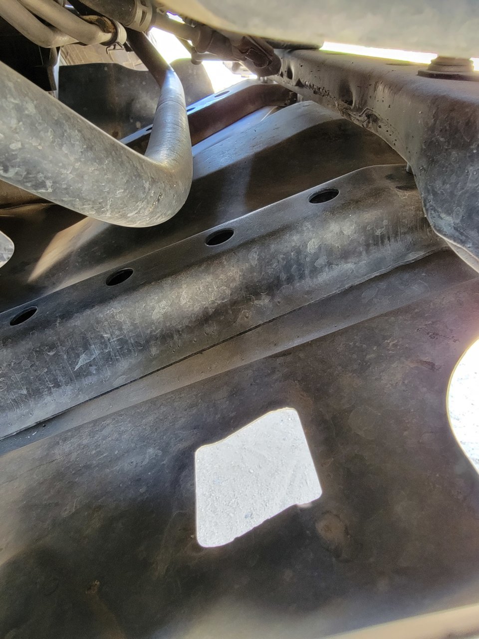

    So I found out that I didn't put the spacers in in that God awful crossmember behind the skid plate so it relieved alot of the noise but it's still making it if I hit a a big pothole or bump. Think it could still be hitting?? Do they make bigger spacers or what. I am newer to offroading and stuff whats the pros and cons of taking it off?

    Think this is too close?

    Drop the skid plate, go for a quick ride, if your noise is gone then it was too close.

    Any way you could update me on this?? Or send me a photo of how it looks?
