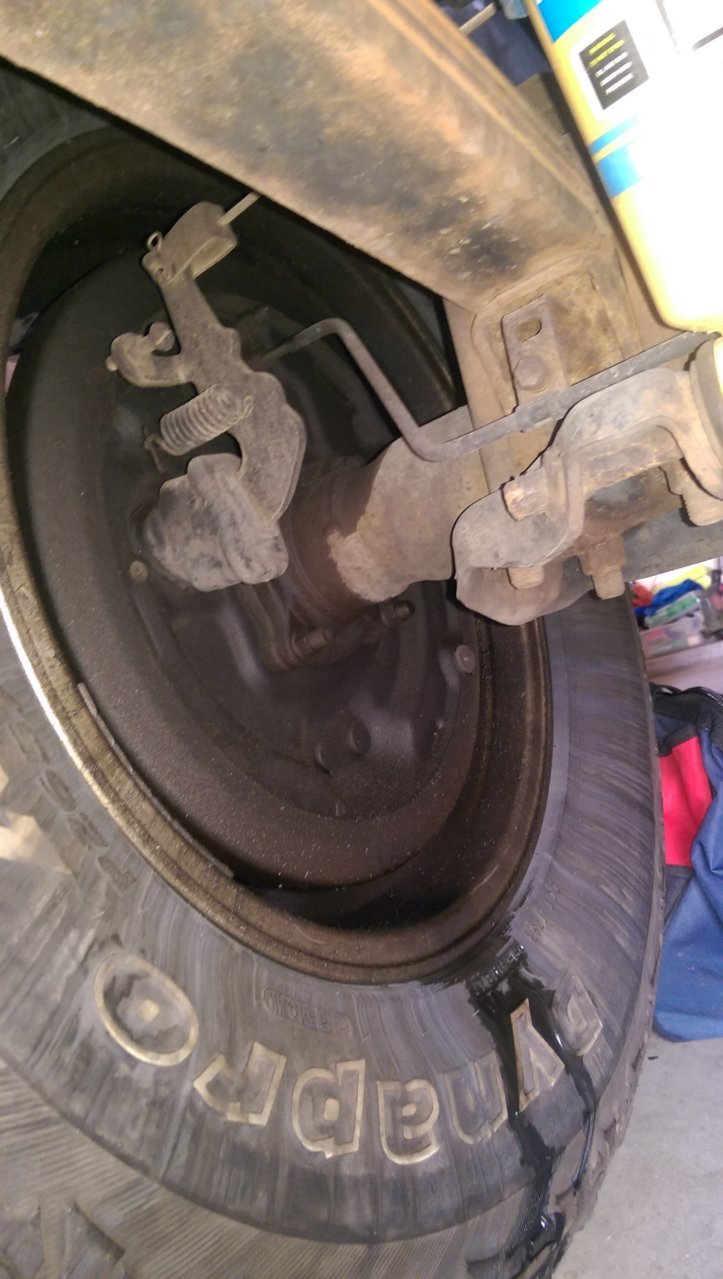

    Not necessarily, depends on how bad it's leaking and if the shoes are wet.
    Sunday would work for me. Shop is usually not crowded on Sundays. Tentatively plan on the 29th to knock out the rear axle. Can you post of a pic of the rear axle backing plate were its leaking?
    I'll get part info.

    Can you post a picture of the backing plate?
