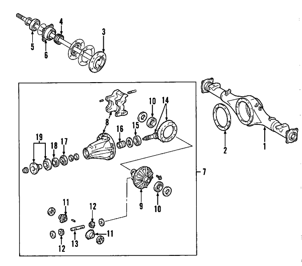

    I'm getting some humming and rattling when I let go off the gas anywhere above 40Mph, I checked the driveshaft and I got some up & down play on it right at the 3rd member.
    Can #19 #18 & #17 be replaced or do I need to swap the whole 3rd member?
    Pinion bearing
    Pinion seal
    Companion Flage
