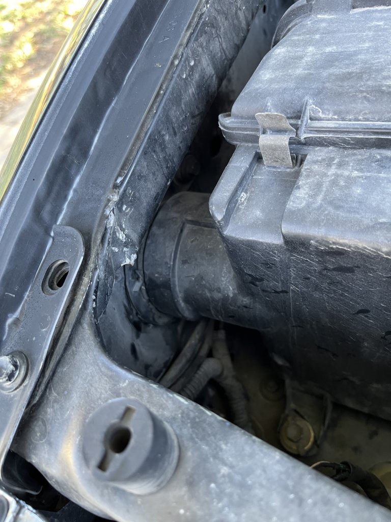

    Would anyone with this issue be able to post a picture? I have this issue but I still can’t find it!

    Is there a way you can send a picture of this location? i cannot find it and its driving me crazy!

    No pic but if you follow the aircleaner to the passenger front fender the plastic going thru that fender which is where your air is being picked up from to feed the motor is whete your vibration is coming from
