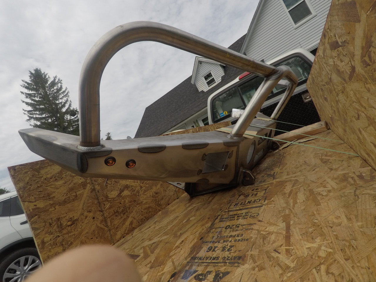

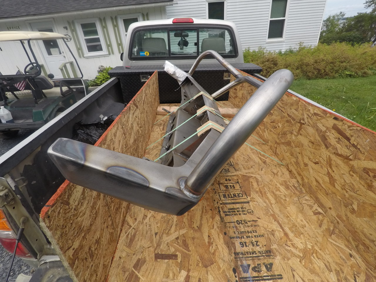

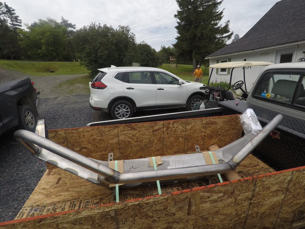

    Well, the wait is over!!! Got my Relentless Fab bumper in today!! Goal is to get it line-x sooner than later. Then I need a winch for it. I am thinking of the Warn VR8 8,000 lbs winch for it. 3/4" recovery points on it (for shackles). Can't wait to ditch the stock rusted out bumper and bolt this bad boy on!! More pics to come, and am going to need ideas on how to mount my license plate to the front bumper. It is Maine, so you are required to have 2 plates. GOPR0391.jpg GOPR0392.jpg GOPR0393.jpg GOPR0394.jpg

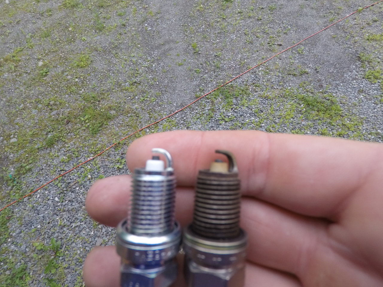

    I have been having issues with when my truck is idling, popping/ misfire. It has 100,000 miles. So I asked around, a few guys said cracked block, another guy said check the spark plugs. So I checked the spark plugs first, found out the Original ones had a gap of .060 to .065, not good. They should be .031. So I bought brand new NGK plugs, checked the gap on them and put them in the truck. Truck idles mint now, no popping/ misfiring out of the tailpipe now. Love when you do not know what it could be, and you replace an inexpensive part, and that fixes the issue. I am still waiting on getting my front bumper line-x. Just have not set up a date yet for them to do it.

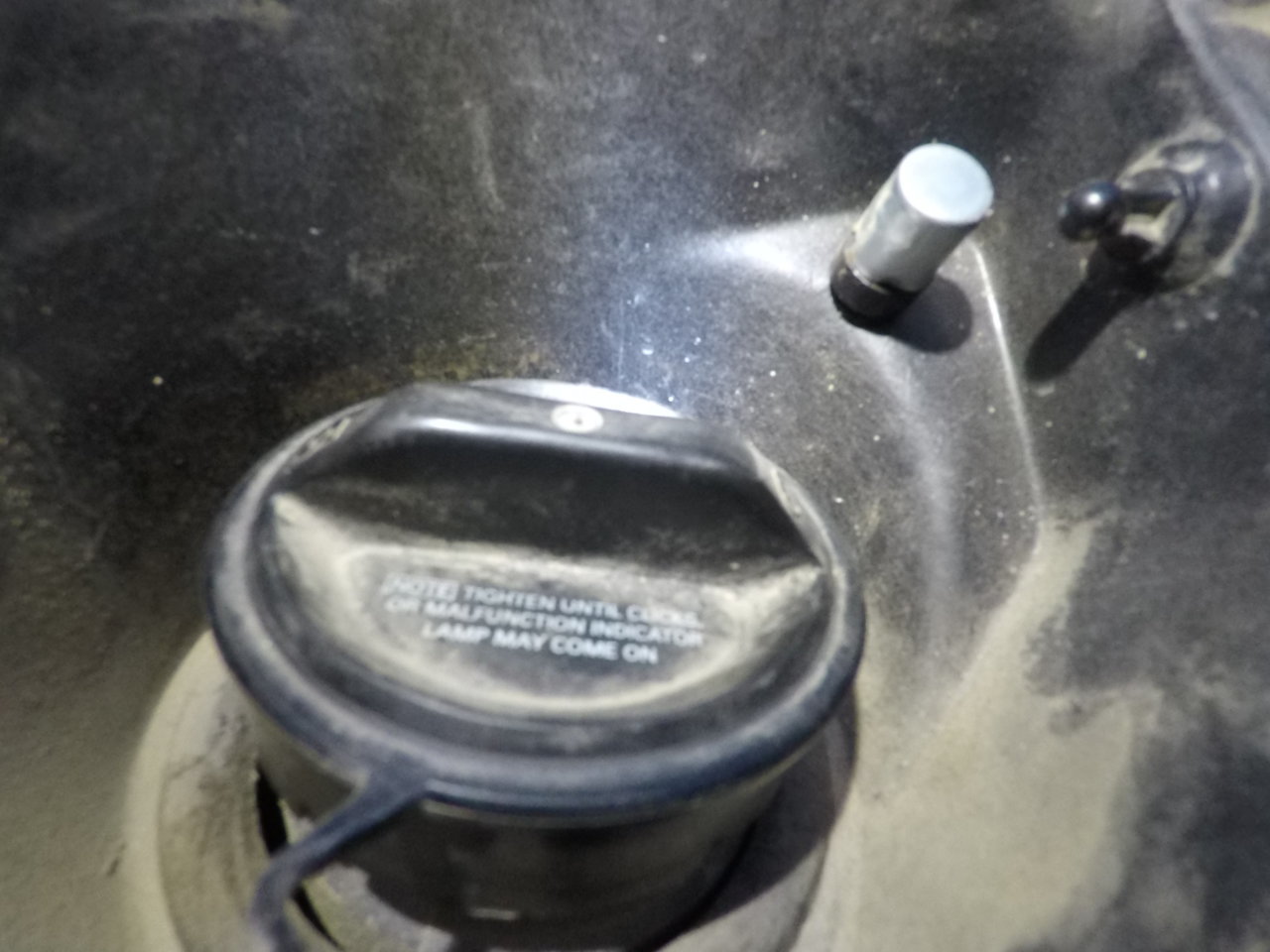

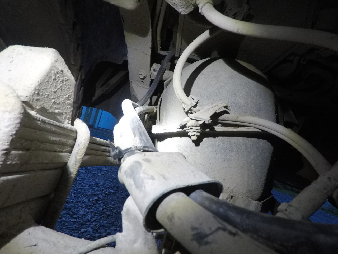

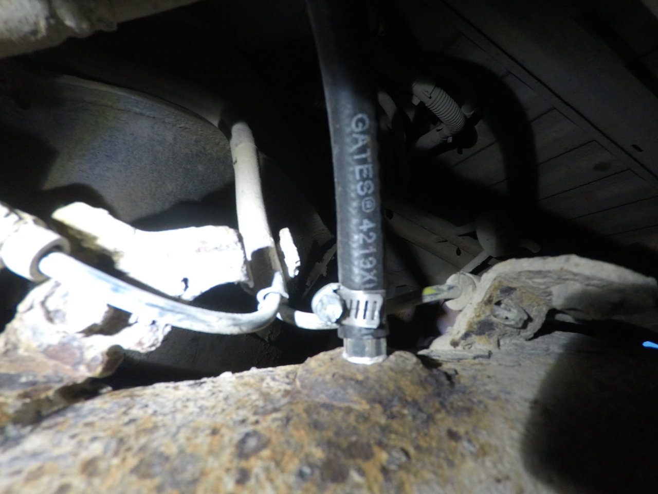

    Diff breather mod done!! I collected all the parts for it months ago, and just now got around to installing it. Peace of mind now!! Will post some pics of it when I get a chance.

    chuckers Well-Known Member
    Apr 1, 2019
    #288710
    140
    Chuck!
    Sneads Ferry, NC
    2004 Tacoma 4 door TRD Off Road

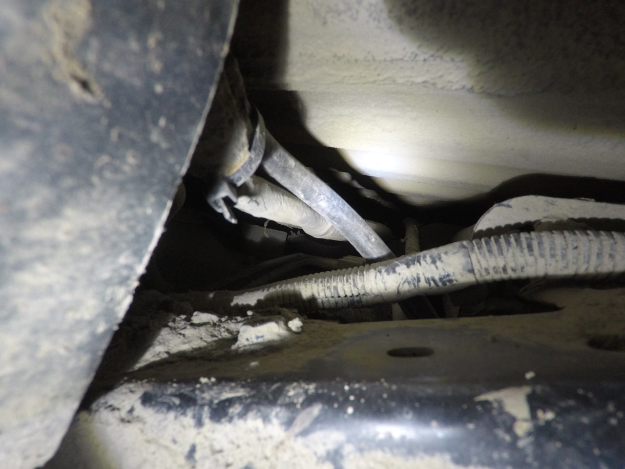

    That’s on my list too. Where’d you run it out to? I see a lot of guys run the hoses to the gas cap area.. post pics
    Hunt/Taco[QUOTED][OP] likes this.

    Total cost for the diff breather mod was like $20. I did the same for mine also ran it to the gas cap area, and called it a day, haha. No it was a little harder than that. I bought 10' or 1/4" gas hose (so I would have enough), and installed the new union into the diff. From there I hose clamped the gas hose onto the breather, and ran it through the rear diff brake line housing (will get pics soon), and up through in-between the gas tank/ frame. I zip tied it in place (black zip ties, not white:rolleyes:, attention to detail is a must). When I zip tied it up by the gas tank/ frame area, I have the hose touching the gas tank, and not the frame. I would rather it rub a little on the gas tank, vs the frame(just how I am, I am paranoid about the frames, lol. Also when doing this mod, I jacked the truck up, so the rear wheels where off the ground, to make sure I had enough hose for when it flexes/ suspension drops. I will get some pics man, just been busy with work. Trying to get caught up on work right now is a killer!!

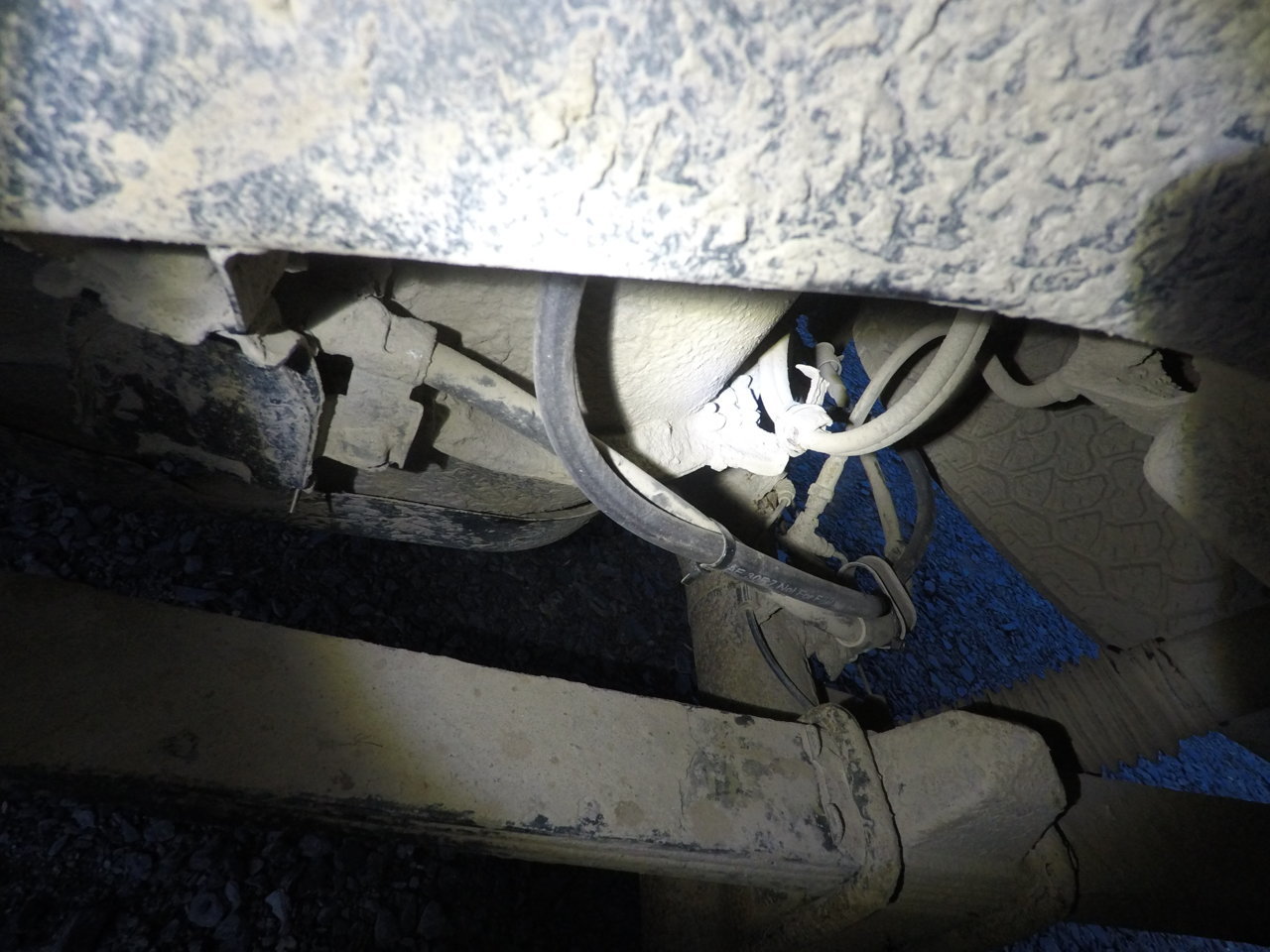

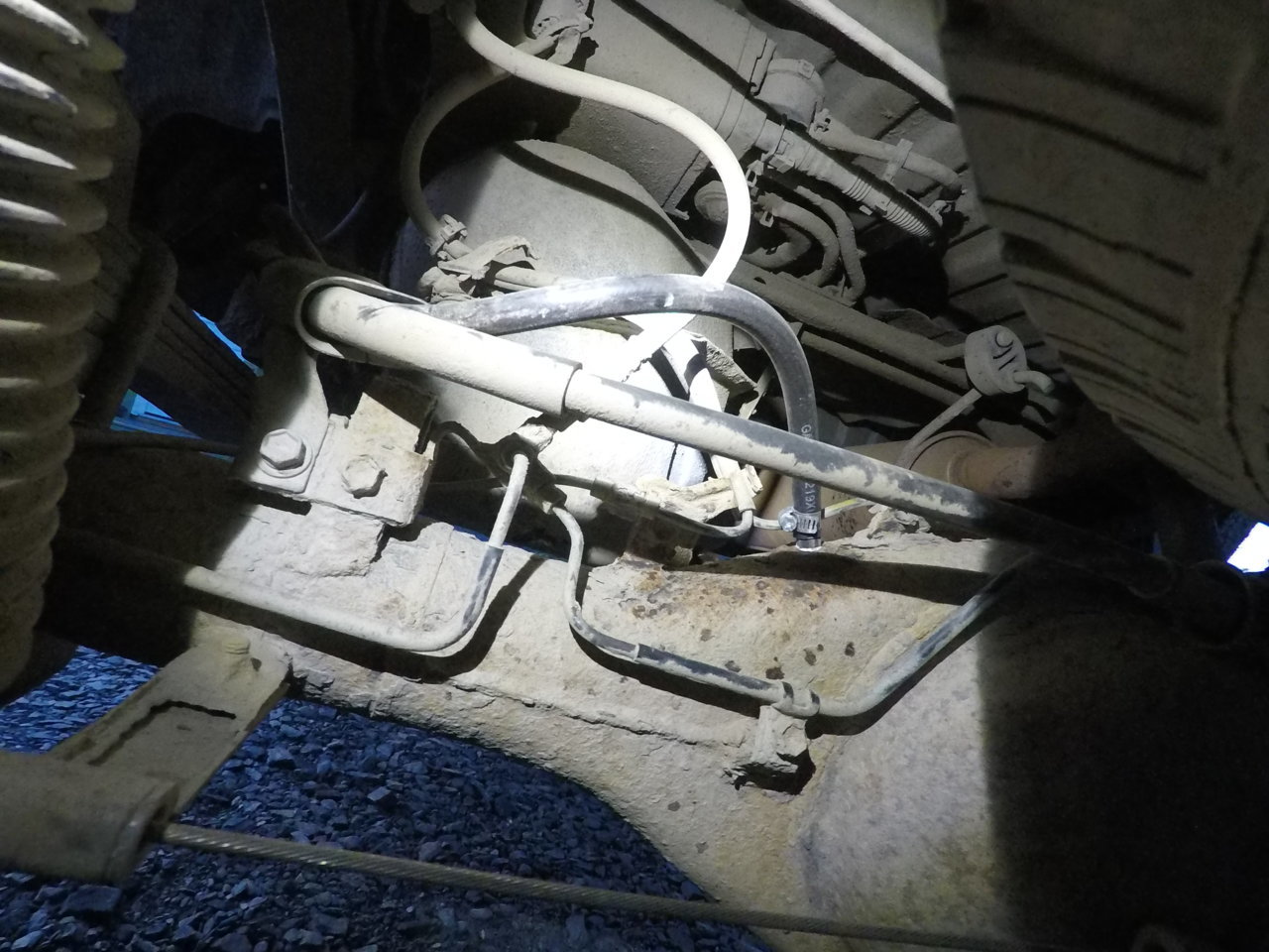

    @chuckers here are the pics for my diff breather mod. Sorry about getting back to you late, been busy with work.

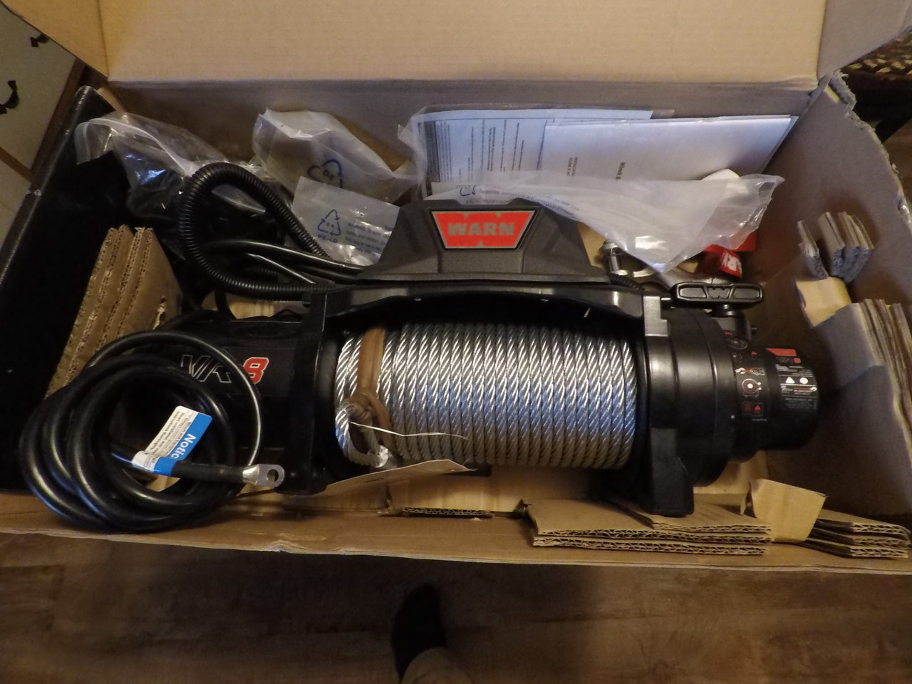

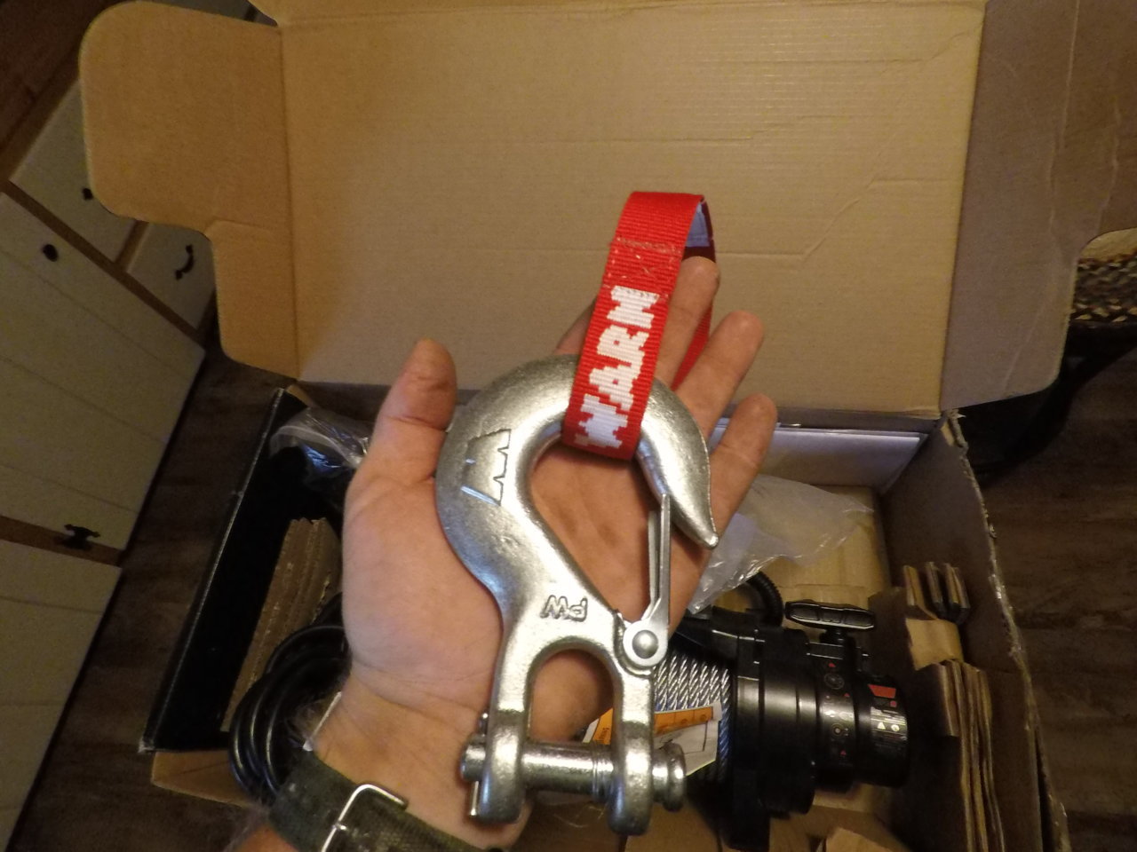

    Got my Warn VR8000 in today. Good things are going to be happening to my truck soon!!

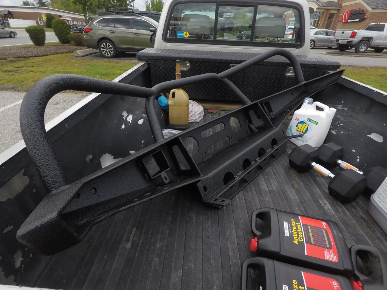

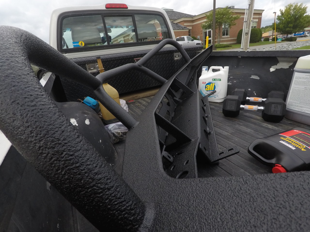

    Pioneer Radio, New rear bumper (that does not really count though). Going to be upgrading it more and more as time goes on.
    Well that step is done primmer/ line-x the front winch bumper. Now on to installing the Warn VR8000, on to the bumper, then the bumper to the truck!!. Picked up some OEM Red toyota Anti-Freeze today (my brother is changing his anti-freeze on his 02 Tundra, that is why so much). I have already collected the front/ rear diff fluid, transfer case fluid, and anti-freeze. All that is left is the transmission fluid for it. I will keep you all posted on the bumper/ winch progress/ take lots of photo's installing it.

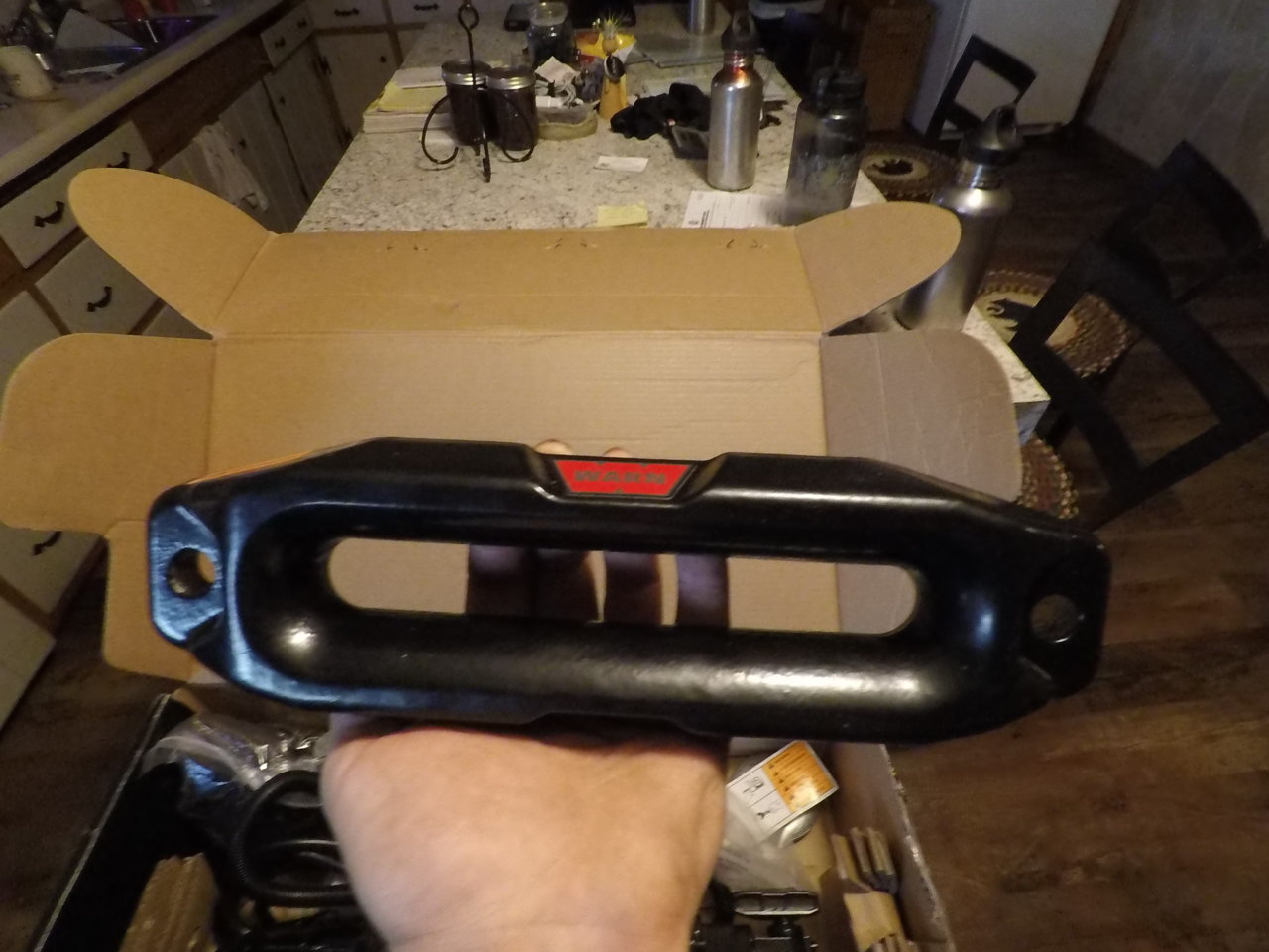

    Since the line-x is so thick, I am having to take the dermal/ lightly sand down the bolt holes for the bolts to fit. Also, my bolts for the hawse fair lead, are to short. So I am going to need to run into town soon, and buy some grade 8 bolts for it. Getting impatient to bolt it up already!!
