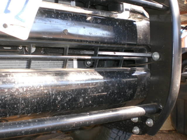

    Well I made new frame mounts for mine out of 1/4inch stock I had around and it helped with the shaking, but only a little. Definately not worth the time to make the mounts. Next I made a horizontal brace that bolts at the spot where the upper brace bolts to the guard. (the piece that runs through the bumper and bolts behind it). The other end bolts in one of the holes in the radiator support. It's tight behind the support, but I cut a large washer to fit in the channel and welded the bolt to it so it's captured. I'll get a pic in the daylight if anyone wants. Basically it triangulates the grill guard with the frame. It has worked really well. The grill guard now shakes about the same as a normal grill guard. Before I did this it was unacceptable. I've had grill guards on 6 trucks I've owned, and none shook NEAR as bad as the hunter.

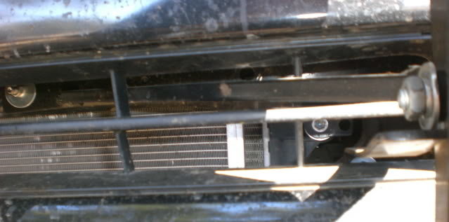

    Here's a pic. To your far right you can see where the brace bolts to the grill guard at the same place the top bracket supplied with the guard bolts. To the far left you can see where I bolted the brace to the core support. It's the bolt with the large washer behind it. I used some 1/2 inch square tubing and some flat 3/16 inch thick metal to make mine, but I would look better made with round tubing. I had those materials laying around and wanted to make sure it would work before I put some actual money into it. It would probably look better if it was braced on both sides(driver and passenger sides. Mine is just on the driver side), but I decided it wasn't worth the extra work and is hardly noticeable if your not looking.
    Here's a pic further away for better reference

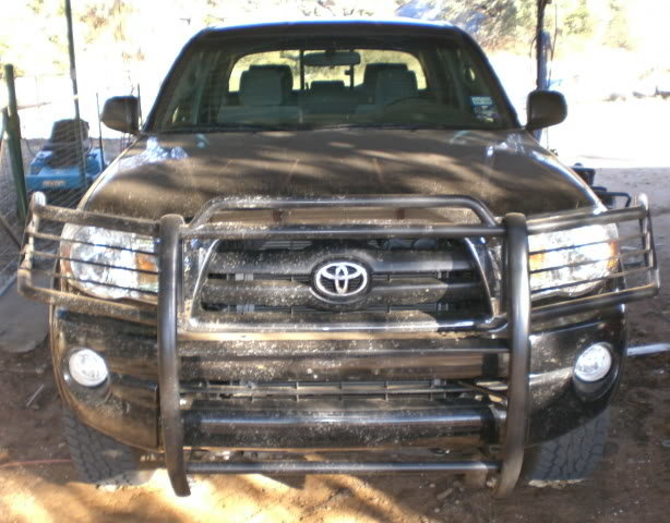

    Sorry the truck is filthy. It finally rained a little bit the other day.

    does it stick out to the sides of the headlights alot??

    There is 2.5 inches of space between the headlight and the guard at the closest point, and a little over 3 inches of space and the farthest point. That pic makes it look like there is alot of space between, but it's just the angle of the pic.

    Thanks for the pics, I'll have to check it out. Do you still get some shaking..did it cut down on it quite a bit. Even my wife asked, " Is that thing supposed to shake that much"

    It still shakes some, but now it's like most grill guards, just a little shake on the harder bumps. I'm satisfied with it.
