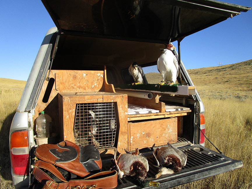

    I hunt a lot. Average 100 days a year in the field. Most of it is not deer hunting however. The majority is bird hunting. Hunting birds with birds, AKA falconry. The dog kennels/falcon perches are one obvious mod, but there are others. Basically making it better off road because I spend a lot of time off road in the pursuit of quarry for my falcons.

    That's a nice setup. I used to make my hawkboxes out of large cardboard boxes. Reinforce the edges and seams with packing tape, nail a 2x4 covered with AstroTurf in it and cut a simple door. Worked well and easy to dispose of at the end of the season.

    Thanks, I put a lot of thought into it. Same set up since I first got the truck 17 years ago. It's held up pretty good. Are you still practicing falconry?

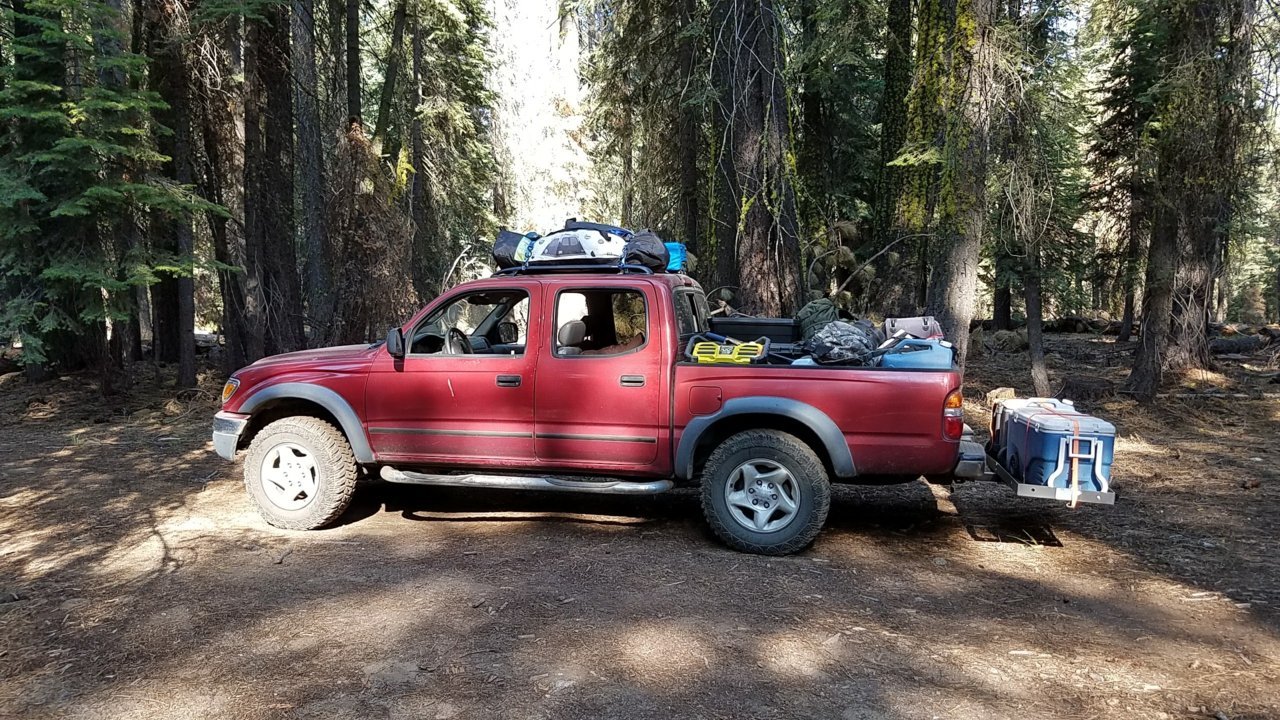

    Pretty much everything on my truck is a hunting upgrade. Had the truck for 13 years and left it bone stock. Here's a pic of the truck, opening weekend deer last year.
    Decided last year was as long as it was going to stay stock. The truck needed a lot of maintenence and I also wanted to take it deeper in to the woods... plus I just wanted it to look cooler :thumbsup:
    Since last November =
    New LBJs
    New LCA bushings
    New UCAs
    New rack bushings
    New inner tie rods
    New outer tie rods
    Tundra brakes front
    New drums/ shoes rear
    New brake lines +3 inch
    New shocks 5100s all 4
    Wheelers 1.5 AAL and 5 lug middle leaf
    3 in lift front
    2.5 lift back
    Waterpump, timing belt, accessory belts, hydraulic tensioner, idler pully, cam seals, crank seals
    New aluminum radiator
    Optima yellow top
    New wheels
    New tires
    Refinished Weatherguard side boxes
    Custom Roof top tent rack (first thing I ever welded in my life)
    1 year later

    I like that

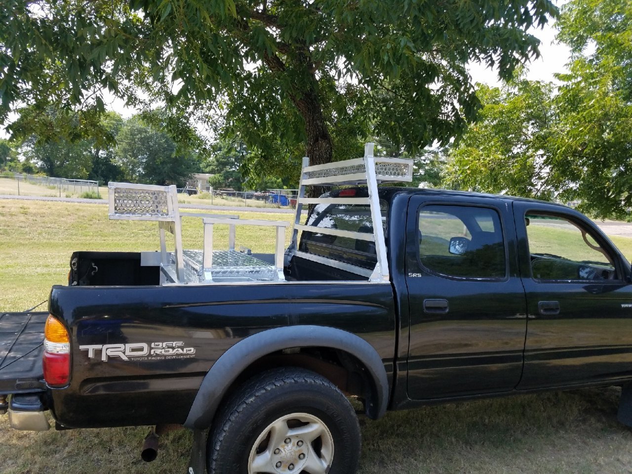

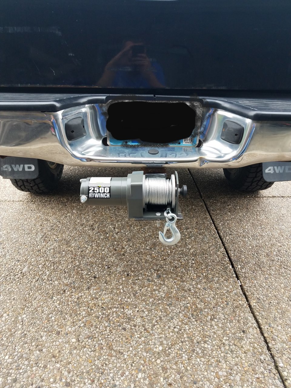

    Harbor freight #2500 wireless winch on back. Removed nerf bars they were a pain and looked terrible in bruch. Curtin receiver on front for #100 Texas Trophy Hunter feeder. Great truck!high rack 1.jpg of high rack
