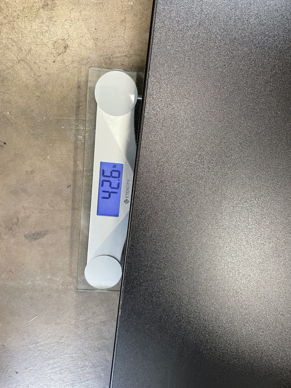

    Install difficulty: 4/5
    Install time: 2-3 hours well focused. 5 hours with children
    Unit weight: 42.6lbs

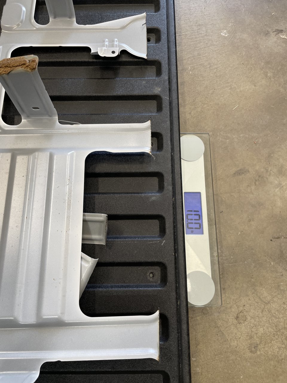

    Removed weight: 10lbs
    Total added weight: +32.6lbs empty

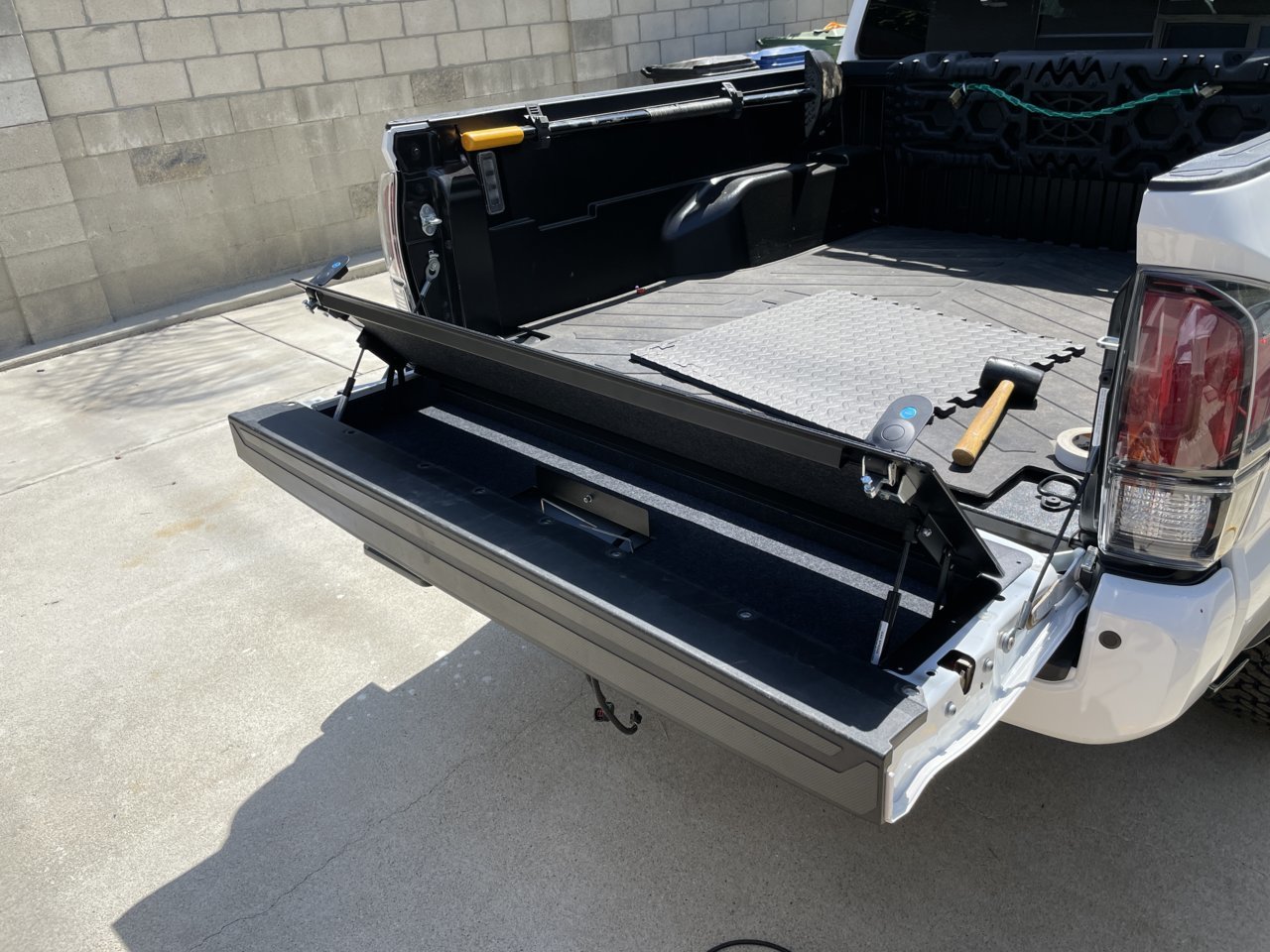

    A rep (or the owner?) from Huracan emailed me to inform that units were in powdercoat and will be shipping within a week. Showed up before schedule.
    Package arrived via DHL/sub well packed and only minorly bent in one corner. Was able to bang it back into alignment with a mallet and 10sec. 10/10 for shipping time and delivery from australia, honestly.

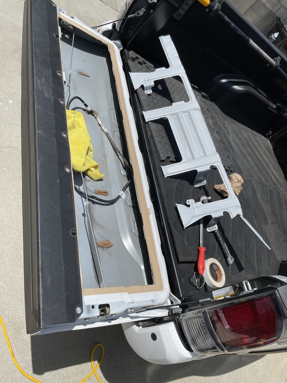

    I laid out the cut template, measured twice, and cut twice times.
    The box is a tight fit and it takes a hammer to get the top/wedge side in properly to seat. It took me three tries to get it right and in the process i sustained some damage (detailed later).
    First try the top opening was not wide enough, so i cut another 1/4" off each rounded corner and widened the bottom of the tailgate by 1/4"

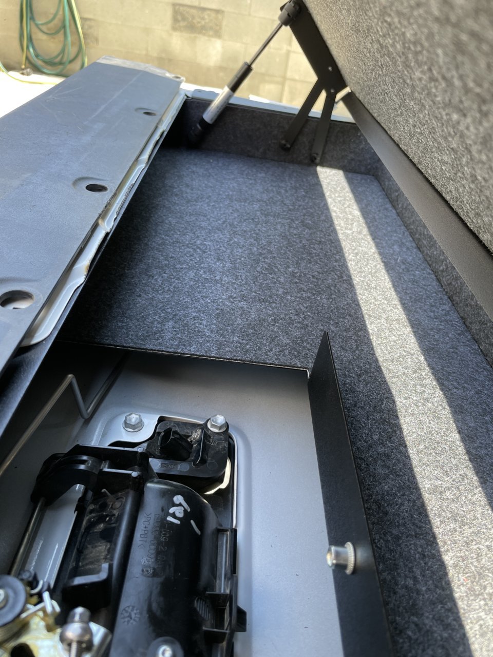

    Install requires you to remove the handle assembly and change lever rods/arms. Tolerance is tight and it took me a few tries to get it right and working properly.
    F it all, the lock actuator did not fit.
    Got everything fastened, skipped the adhesive step in the instructions. I will be doing a layer of silicon around the entire box.

    -Build quality is nice, but i can smell the laser burn.
    -It is quite sturdy, rigid, and the door action is nice and solid.
    -It locks stuff inside. Fits a long barrel.
    -Very discreet
    -Can still close gate with one hand.
    -Fit and finish after install is pretty clean
    -Tolerances are within mm'z
    -Everything was included, instructions were pretty comprehensive.

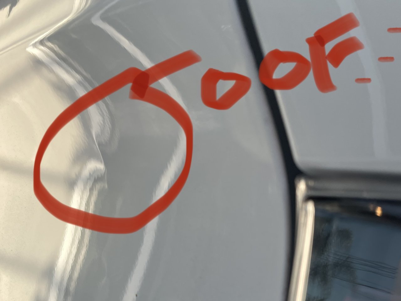

    -Completely my fault, but it is fairly easy for the box to touch and dent the outer sheet during install. I sustained two small line dents in my tailgate from the top/wedge side of the box making contact while trying to squeeze it in. Make a bigger hole than the template says.
    Pictured here, a line dent from the top of the box sliding against the outer sheet. I have one on each side =(

    -LOCK ACTUATOR does not fit. suckfest. You can shove it in but the angle of the actuator isnt ideal and will probably fail quickly. I'm currently fabricating another bracket to get the actuator to fit into the 12" boxed pocket provided by the box.

    I did. It was actually pretty easy to modify the existing pin setup and flip the actuator into its place without any cutting/fab. It took a while to get the tension right, and now the OEM actuator makes a very loud sound like the older R4T/TM lock kit that was known to be "noisy"
    I dont mind it. I can tell the sound difference between a full actuation and not, confirming if it was locked/unlocked before i hit the button.
