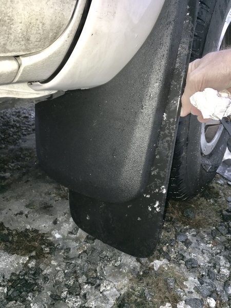

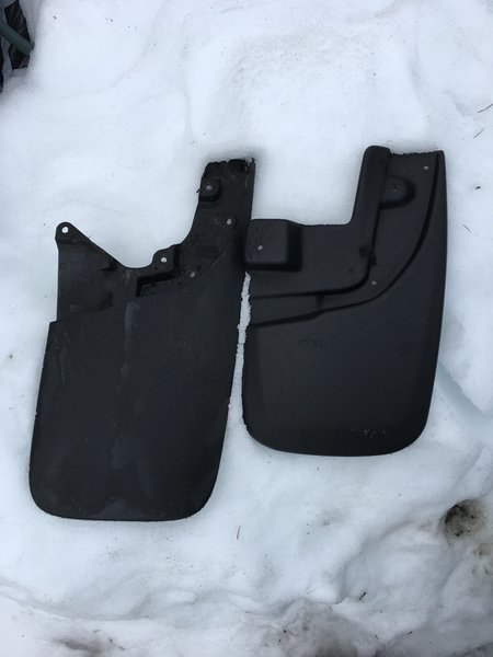

    I recently added the Husky Mud Flaps to the front of my 2nd gen after receiving the set for Christmas.
    The OEM ones were prone to drag on speed bumps and bottom out even during light off roading. I considered removing them, however, they do seem to catch quite a few rocks and also keep the wheel spray off the side of the truck.
    They were super easy to install, using 3 of the original screws plus 2 new ones. So 5 screws to secure vs 3 and 3 clips that were stock. I suggest you align and install the new screws and clips first (the instructions say to do this last) for a better fit.

    I love the huskys. The OEMs also flap in the wind like a boat sail. These are much more sturdy.
