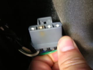

    I found a couple things searching around. On Toyotanation I found this :
    On this thread :http://www.toyotanation.com/forum/6...nt.html#/forumsite/20543/topics/246763?page=1
    Checked that, nope. Nothing seems loose there nor any burn marks like the pic.
