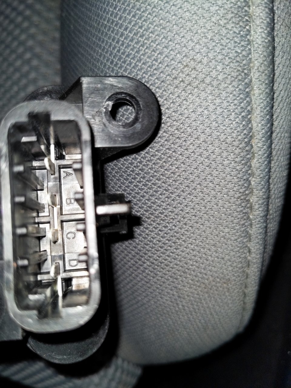

    Coming back from work today and noticed the fan only blows on high.

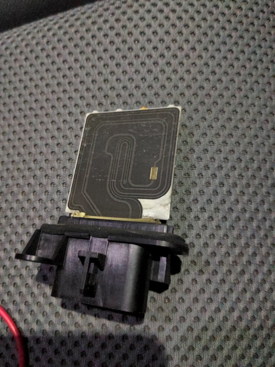

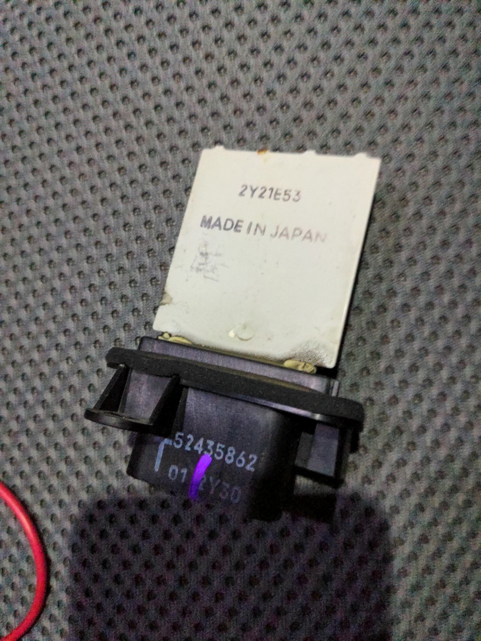

    After some research, I pulled the fan resistor to check. Just getting "ol" reading (bridging pin 3 to all other pins) from the multimeter, so I assume its shot.
    My 2013 is at 170K miles right now, and I've only owned the truck since 130K. So I can't say for sure if this has been replaced in the trucks life before, but even if it hasn't it annoys me that it failed at this mileage.
    I would prefer to find an upgrade to the OEM, if one exists.

    Not sure if its relevant, but there appears to be corrosion on the resistor card itself (not the pins).

    So this newer 4 pin in a square was introduced in 3rd gen but backwards compatible? The resistor (82141-04Q80) definitely looks beefier than the original.
