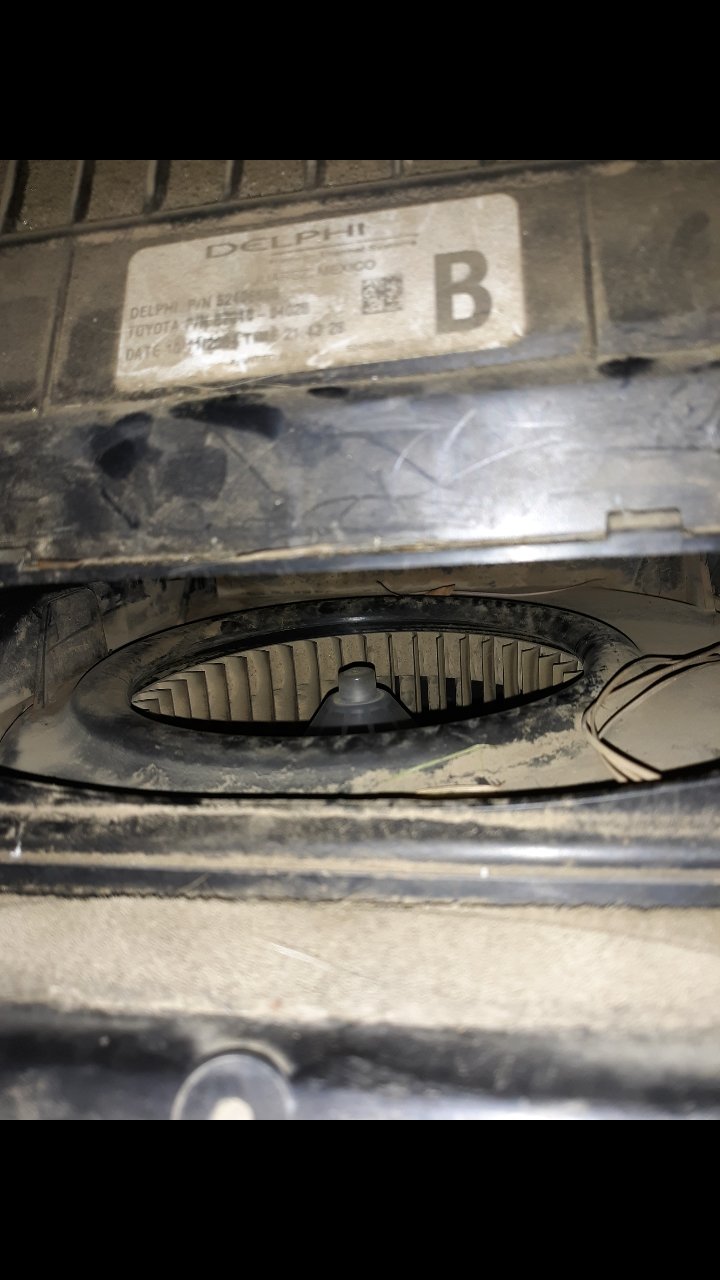

    Where is the noise coming from?
    Have you checked the cabin air filter area squirrel cage?
    Stuff likes to sneak in there.

    Yeah; Entire squirrel cage was replaced and though this wasn't the source of the noise it was for the best because the bearing was worn out (I only paid $80 for the part through my mechanic installed, when the stealership wanted $240 just for the part); If it needs to be replaced again, I will do it myself because it's so easy. I thought that the cabin air filter may have been the problem because it got snagged on the squirrel cage a couple times, but I don't think it's the problem...

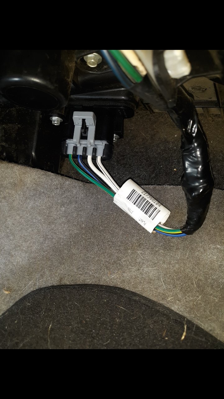

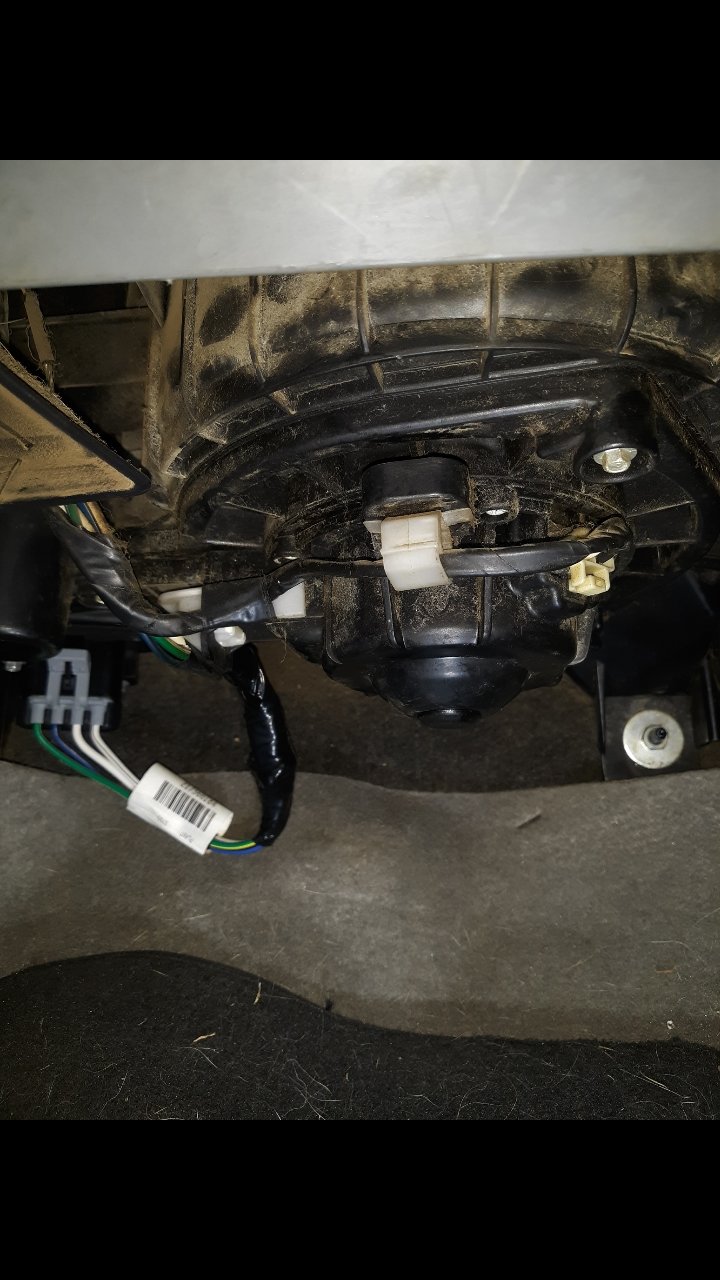

    Well, new resistor and connector fixed mine and my friends and my almost stepsons tacomas so I didnt have to go any farther.
    Sounds to me like you have a loose connection or your blower motor is sticking.
    I see a couple of connectors on the motor itself, but I couldnt tell you which one to check next.
    Maybe someone else that has done it will chime in.

    Orrrrrr.....
    You could test all the connections, pull the motor and put 12v to it annnnds...

    No really, thanks man I just started tracking that down, it was only working on high.
    Youve confirmed the blower works on all speeds after you smack it eh.....
    Maybe the bearing just needs a shot of pb and a connector just needs a dab of solder...
