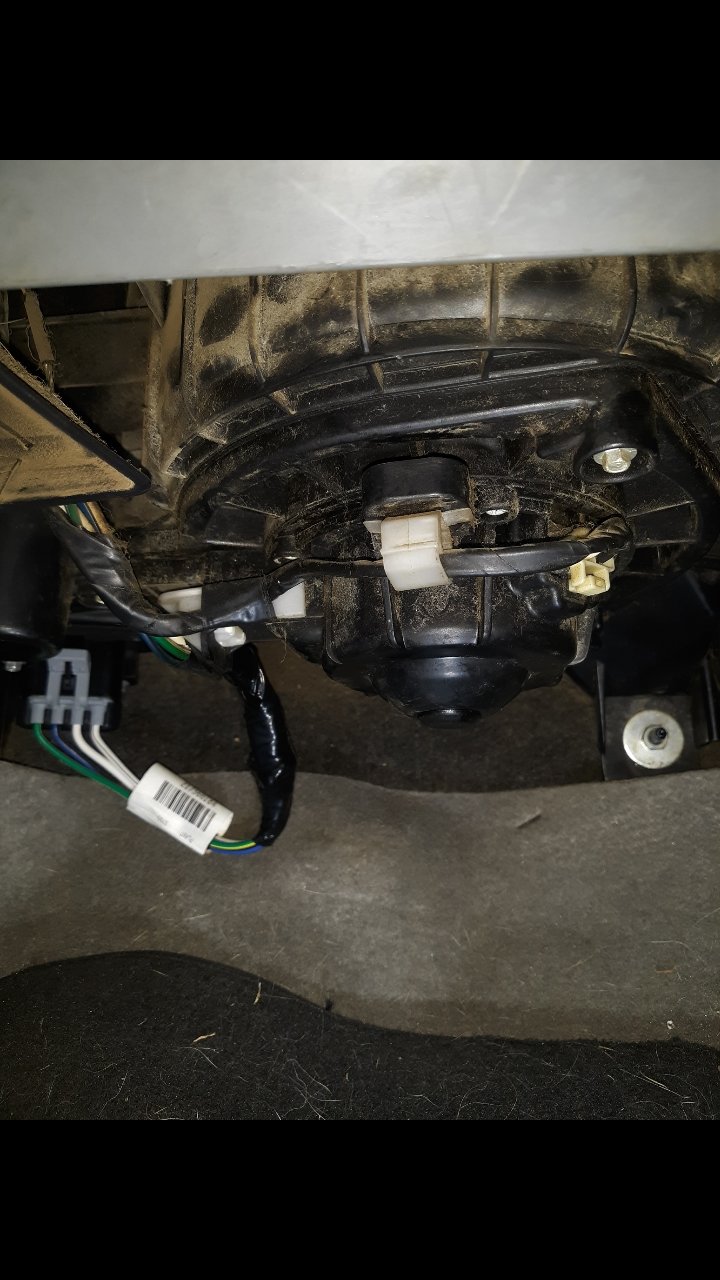

    Now we're getting somewhere.
    Pull the glove box and check all those connectors.

    Does the fact that it makes a buzzing or whirring sound help?

    The bottom is your blower.
    Follow the wires to the white thingys, wiggle, repeat.

    My brother was saying it sounded weird like it was working hard. After he smacked it and it worked he told me to order a blower motor if it didn't work again so we put the glove box back on and closed up shop. Now I'm having a beer and making dinner!

    Blower motor bearing, blower motor not getting enough juice because of bad connection or something in the squirrel cage.
    Do you smell smoke?

    Everytime I get in and start it I have to smack the glovebox to get it going then it pretty much is fine till next shut off and start it seems like.

    I did check all the wires underneath in the very beginning of all of this, wiggling them and checking them to see if it would turn it on but nothing changed.
