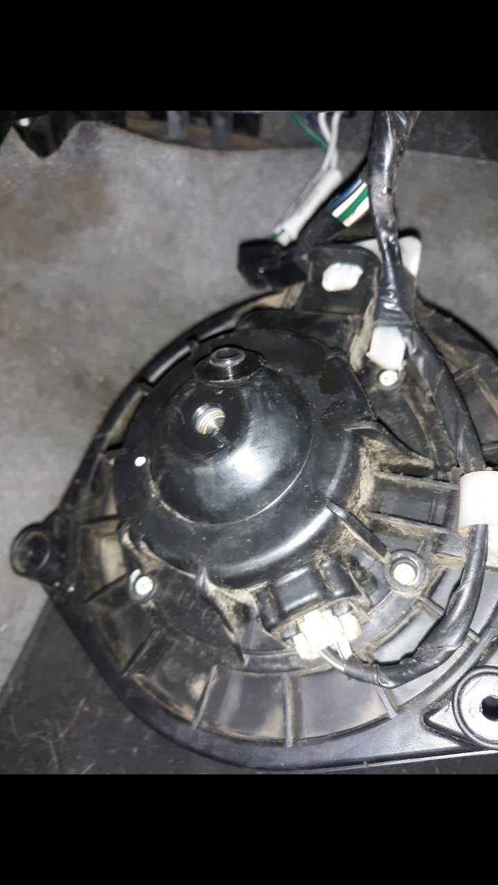

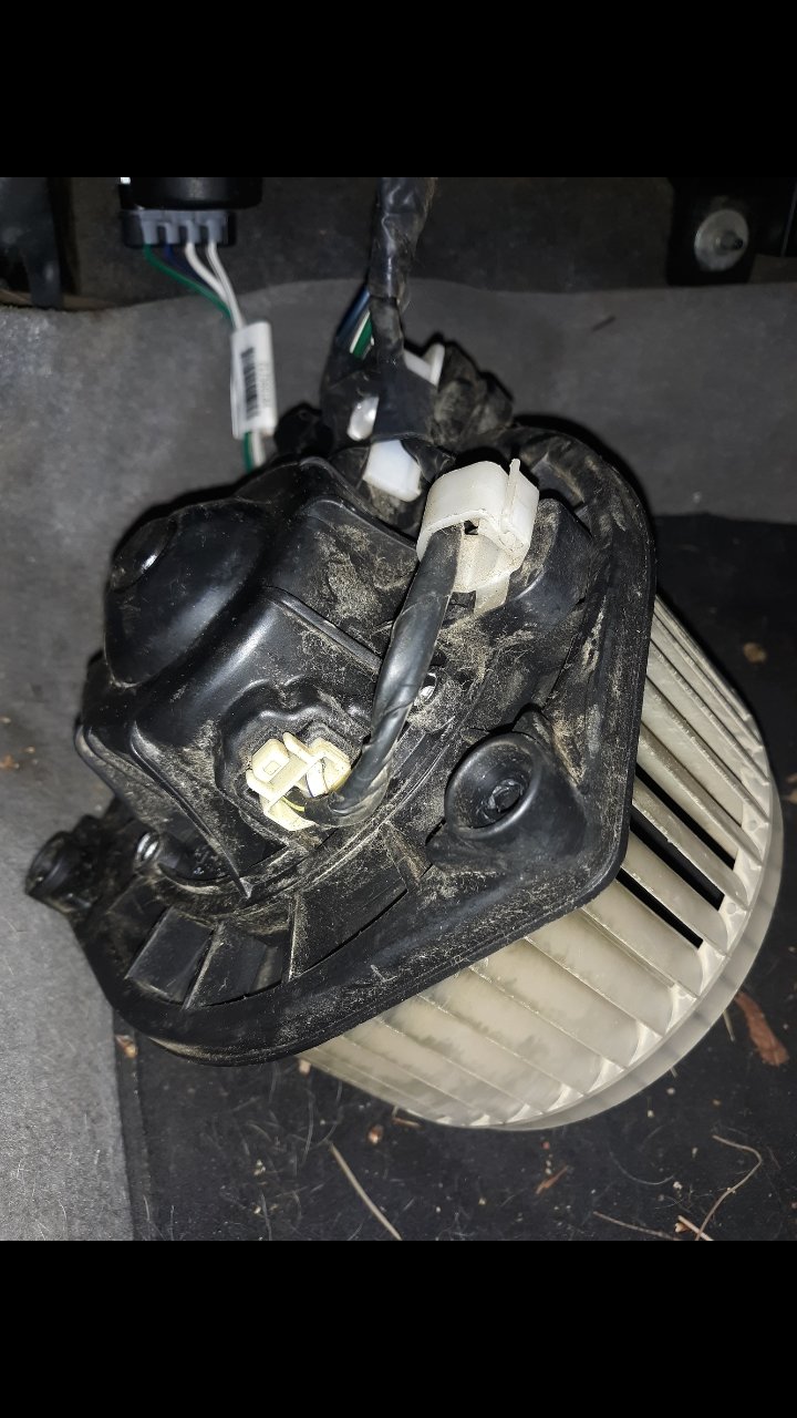

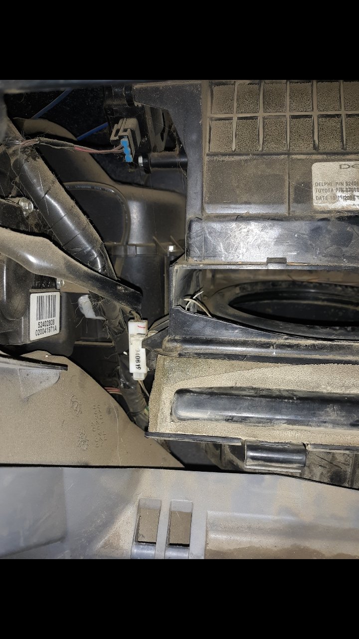

    So I see two connectors.
    One on the side of the cabin filter housing and one up top left black with the blue thingys, and one on the motor itself.
    Needed to blow this out anyways.
    Pro tip, dont turn it on high while its out unless you want to fend off a blower motor helicopter.
    And wear safety glasses.
    Looking to see how the squirrel cage comes off without breaking it.
    Saved more than a few back in the chevy days with a shot of oil to the bearing.
    Have fun

    I feel pretty confident in changing this out now, so hopefully I don't mess it up :rofl:

    Its so easy even a jungleman can do it.
    While its out,,,
    Theres no reason to pull the squirrel cage.
    On the bottom, or top when its out and inverted, is a rubber cap that easily pops off with a tiny screwdriver.
    And bam.
    Give that bearing a tiny shot of your favorite oil.
    Mine looks pretty good for a 16yr old blower bearing.
    Theres even some oil in there still.
    Shot of pb and back in she goes.
