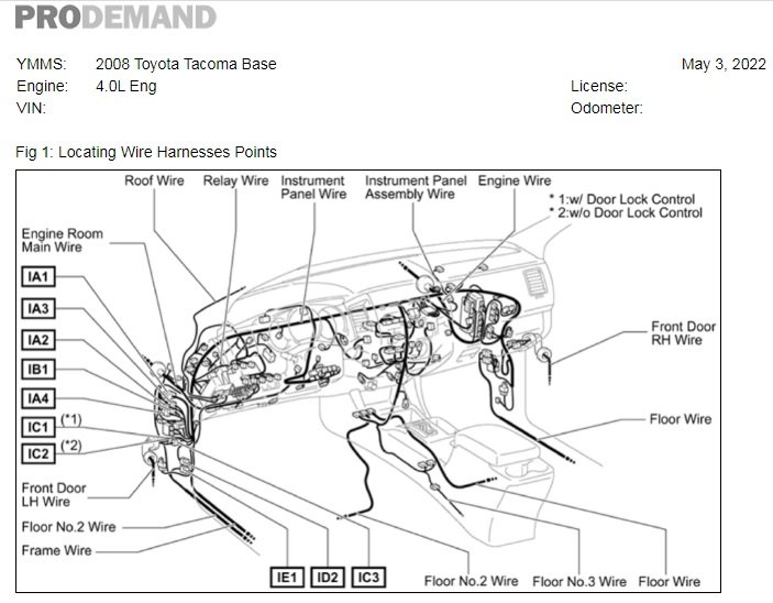

    Any idea where the B/Y goes after it splits after the heater relay? Or where I might find IA4 in the instrument panel as I am pretty sure that is where my issue is at. Want to inspect the connection and possible pull a new wire to the blower motor.

    Is this what your looking for?

    Yes, that is exactly what I am looking for! Thank you!
