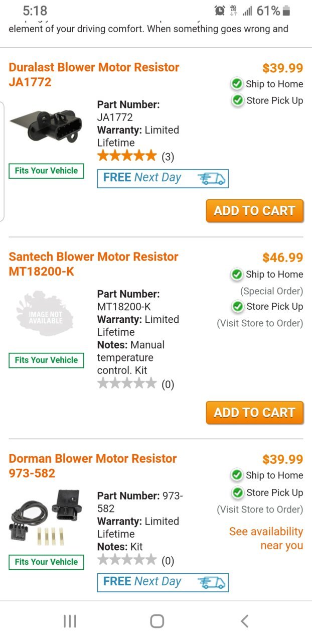

    I think I can get this in town, it's more but I dont have to wait til next week

    The Dorman looks like the same kit. Just make sure you get one that comes with the new connector

    I wanted that one in the first place but it wasn't at my store so I'll just have to try to exchange it...

    I have done this 4 times already. It’s not a technically complex job but it’s physically painful. The supposed new design connectors that are claimed to fix the issue are bullshit. They don’t fix it, it will still reoccur. I would put plug in connectors on the wires so when it’s time to do it again you don’t have to mess with the harness side of things.
