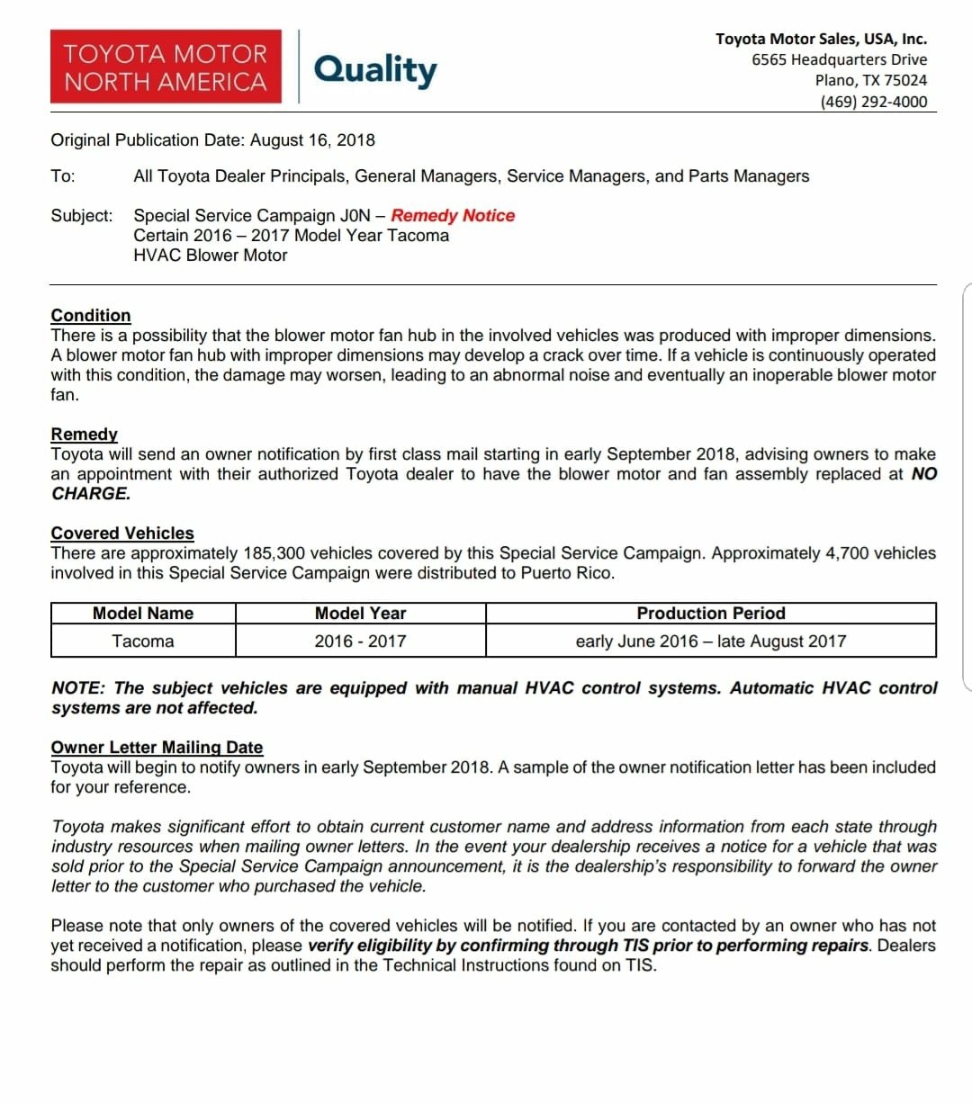

    Just checked the Toyota Owners Site. My truck isn't included (manufactured in Aug 17)

    So it appears only the manual HVAC are affected...has anyone with an auto climate control experienced a failure?
