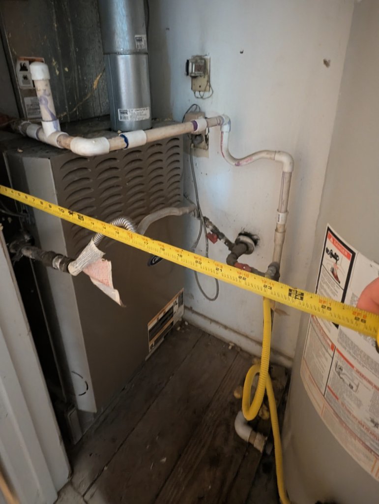

    This week I celebrated Labor Day by with my central AC going on strike. Compressor seized. The tech got it turning with a jump start kit (I had no idea they made AC jump-starters), but when it runs it squalks like a banshee with it's nuts in a rat trap. Well shit.
    Here are my options.
    A) they sourced a compressor and have the install scheduled to rebuild my system. 14Seer, uses the naughty R-410. $4000 to fix, 1 year parts& labor :eek:
    B) new system. 16Seer. Uses the polar-bear saving R-454B. Standard 10 year warranty. Gonna be close to $12K.
    I can pay cash for A. I would feel more comfortable financing B.
    What would you consider?

    Other considerations: this is going to be a colossal bear to wrestle out of that closet.
