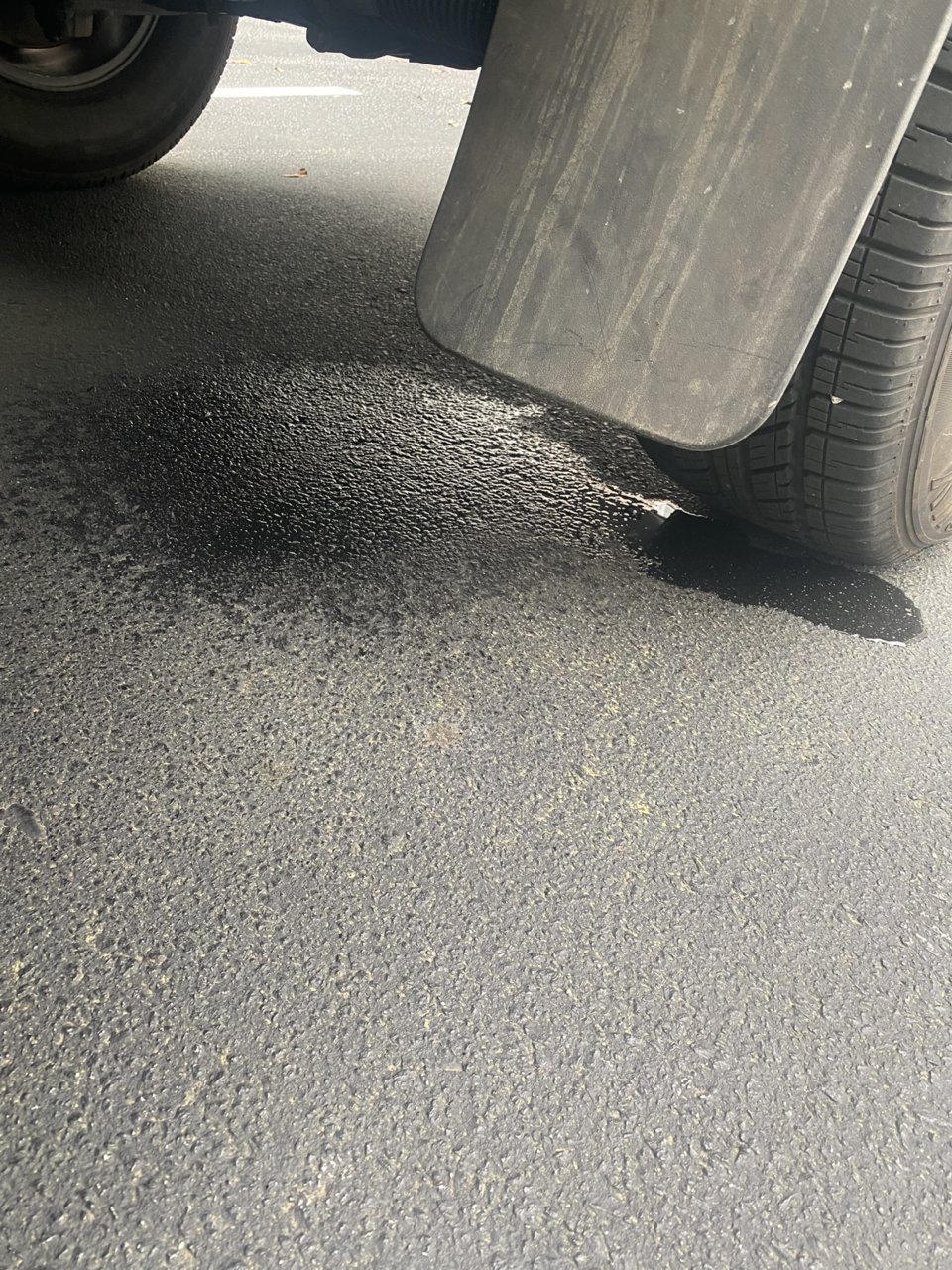

    Started experiencing something new on my last trip with the truck. Recently drove ~200 miles interstate and noticed when arriving at the hotel the passenger floor was soaked. Had the A/C on the entire time on recirculating. A/C blows extremely cold all the time and I have never had an issue before - I did have a vacuum pulled and new charge last summer. Pulled the floor back and ran the truck A/C on recirculate for ~25min today also pushed a stick into the drain to make sure it wasn't clogged.
    I noticed after running the ductwork was all wet to the touch. I believe this is the source of my water issues as it drained well through the evap drain. Has anything experienced this before or does anyone have an idea what causes this? My only guess would be the drier or condenser but I'd rather not toss parts at it until I know.
