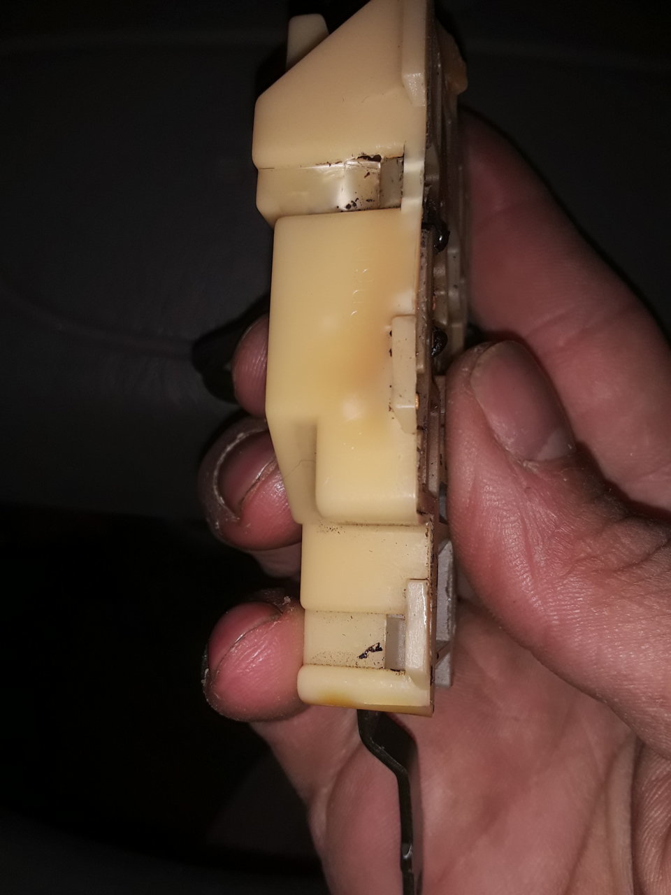

    Hey all,
    The other day my selector switch broke, internally, spilled coffee shorted speed 3 out and stopped working. Then the selector part got all loose and it stopped pumping air out. So I pulled the switch apart and I got the switching mechanism put all back together and functional, still doesnt blow any air.. could it be the resistor? I cant think the switch basically falling apart and the blower motor resistor going out at the same time would be too much of a coincidence. Maybe a fuse or relay somewhere?

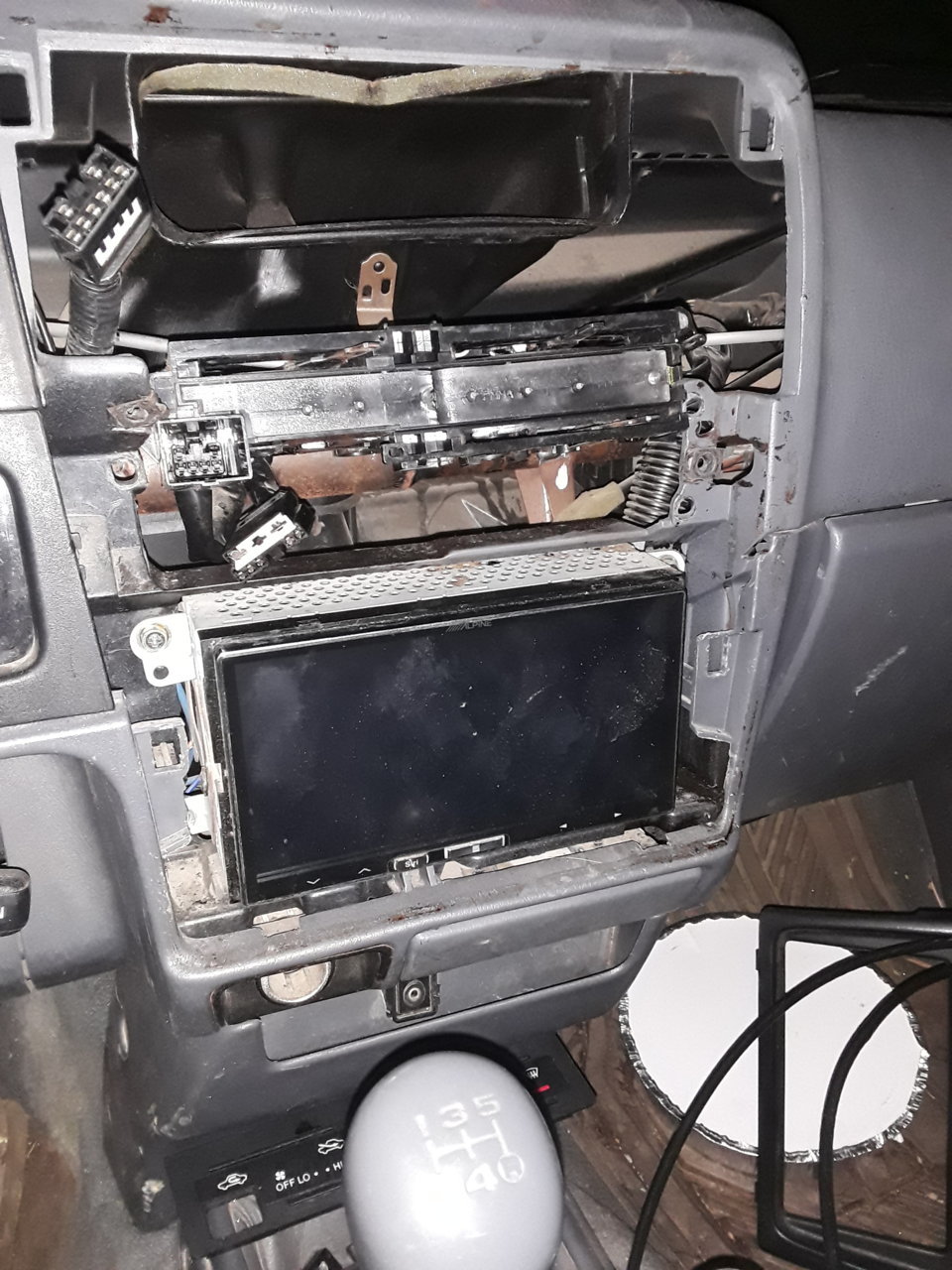

    Then you have to take the 3 screws that hold the air control box in place, you'll be able to lift it up and unplug the connector.
    Make sure to take the green bulb out of the socket it goes into first before you pull the switch out.
    Then press these 2, top and bottom tabs with a small flat screwgee, may have to get another one to put in between the 2 plastic pieces.
    Be careful, there is a tiny metal ball inside that keeps your position where it's supposed to be when you move the selector, it will probably go flying if you split and open the 2 halves too quickly.
