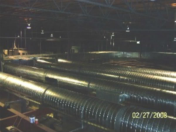

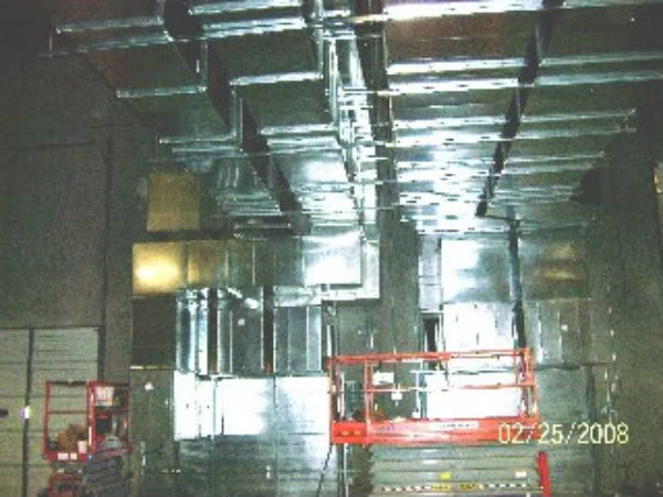

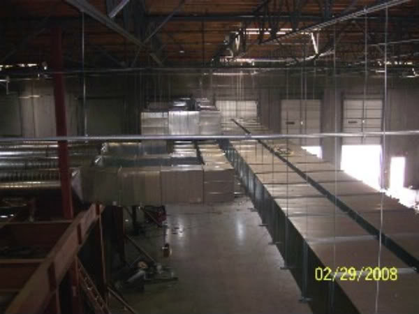

    looks like union work. i do mostly residential work. at my old place, we did commercial. looks great. all that duct work lined?

    i also like the round to square fitting.

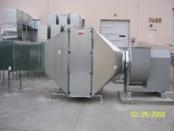

    Thanks Joey, no not union, myself & 4 other installers hung all this duct for an indoor training facility (multiple environment shooting range) for Blackwater in San Diego ,Navy seals also train here. somewhere in the neighborhood of
    85000-87000 lbs of metal, believe it or not none of it is lined, this is all exhaust ducting evacuating gunsmoke from facility, it runs thru 7 walk-in hepafilters before being released outside air, triple stacked rec. duct with the square to rounds is 34" Spiral pipe in 50ft lengths & oh yeah the first 6 years I was in this trade it was existing residential (retro fits & as-builts) & some new resi. tract work
    it woulda been fun to do the layout & brake all this duct in the shop but the job was so big & time short so we farmed it out to a bigger shop for metal fab.. I haven't done any bench work in years kinda miss it ;)
