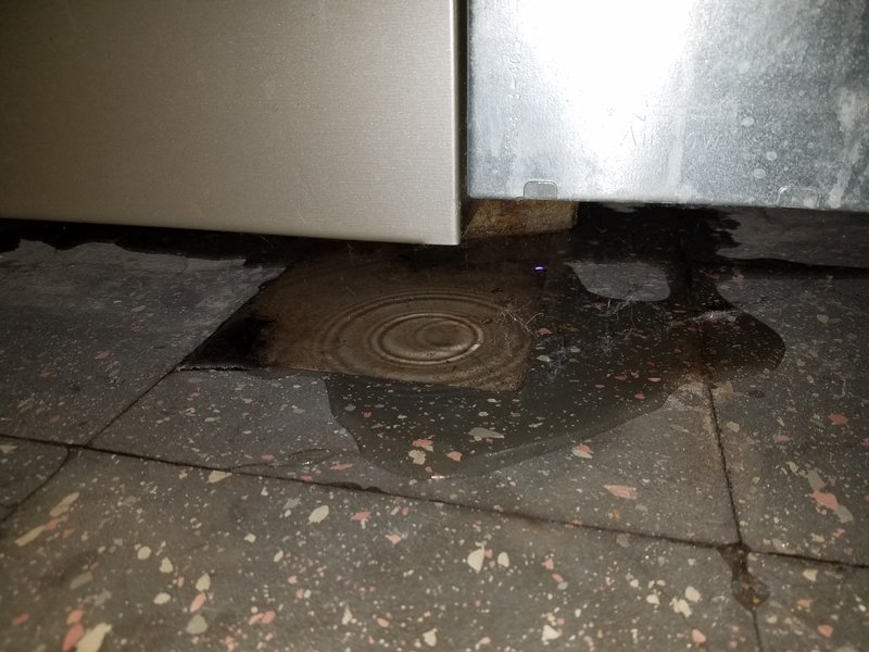

    Hey guys...first time running central air this year and have large amounts of water leaking from unit in basement.
    I can't seem to find any way to open this up and look. If I could, should I or will I be opening a can of worms?
    Thanks

    Your condensate line is clogged and overflowing the secondary drain or out the condensate pan?
    No water draining outside?

    Or maybe the condensate pump is toast.

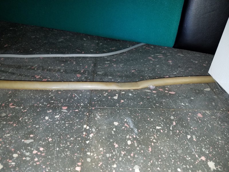

    Geeeeez....why didn't you guys tell my wife not to set our plastic folding table on the condensation tube???
    I think I "fixed" it.
