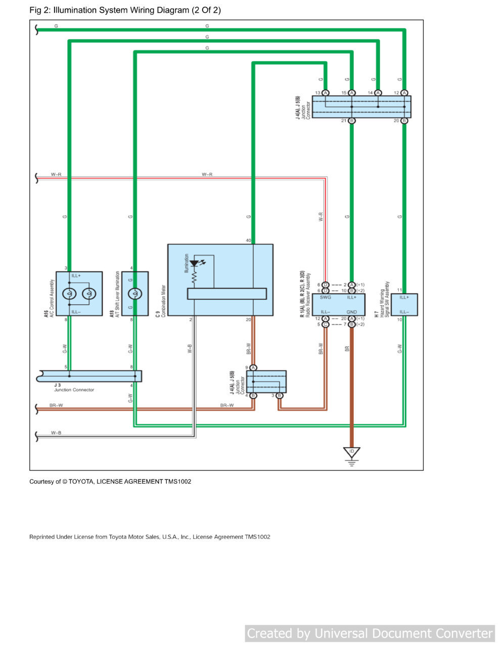

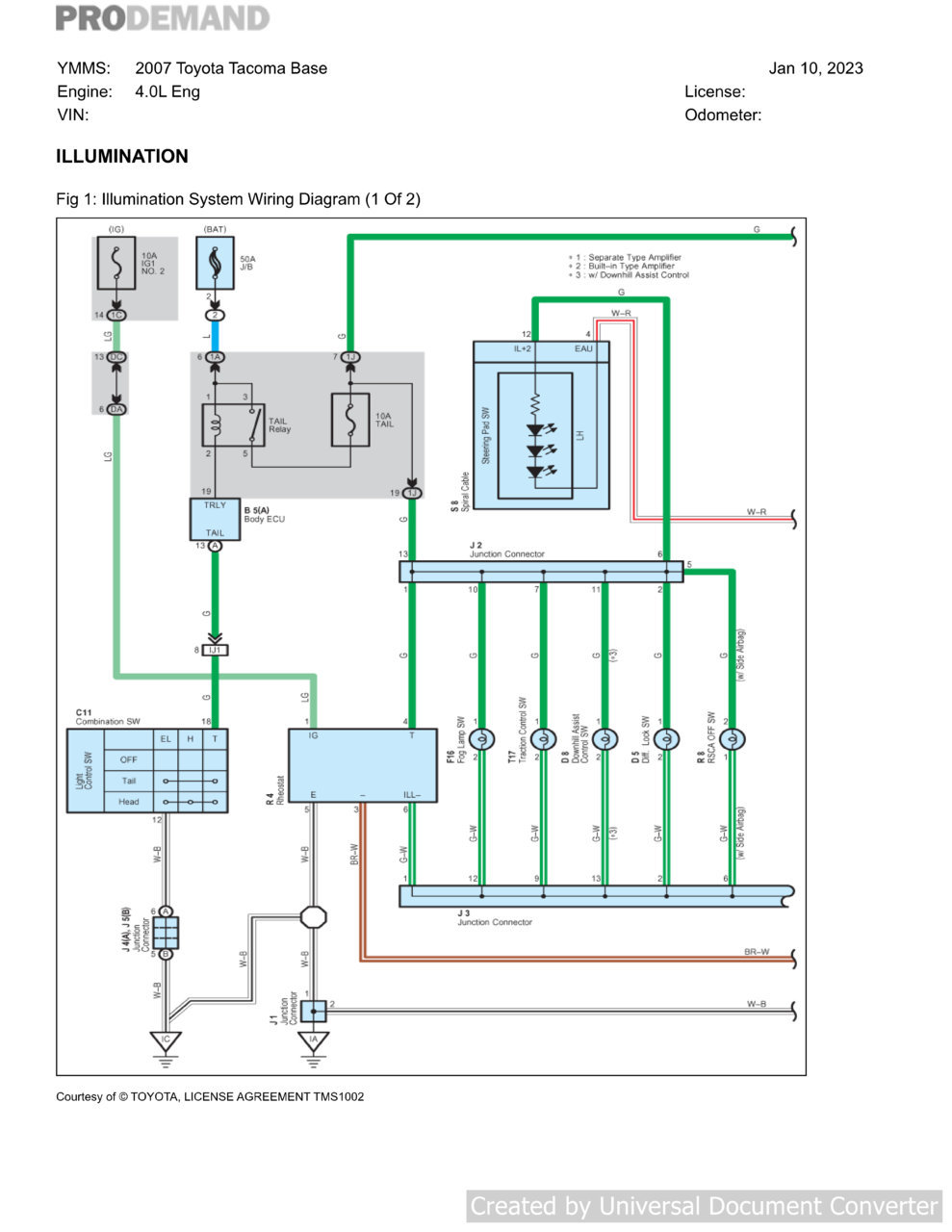

    My HVAC panel (with three knobs, right under the radio) light is out. Which electrical circuit is that?

    If you are referring to the backlighting it is powered by the TAIL Fuse (10A) in the interior fuse box and variable ground is provided through the Rheostat knob for dimming.

    That would be the backlighting/illumination, diagrams posted above.

    Are your tail lights working? If they are then there's nothing wrong with the TAIL Fuse and more likely either the bulbs are burned out in the A/C panel or there's an internal problem with it.

    Yes. It is odd that those knob lights would be on the same circuit as the tail lights

    Could also be a failed rheostat judging by that diagram.

    Not at all. Dashboard backlighting is typically powered when you turn the park / tail lights on.

    Not really, alot of vehicles have the dimmer circuit powered off the tail lights.
    True, my other question would be are all the other backlights working.

    But if the radio and switch backlighting works then it’s not the rheostat.

    yes, all the other ones are fine (like the main dashboard)
