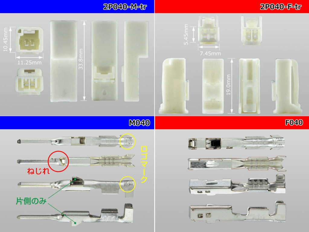

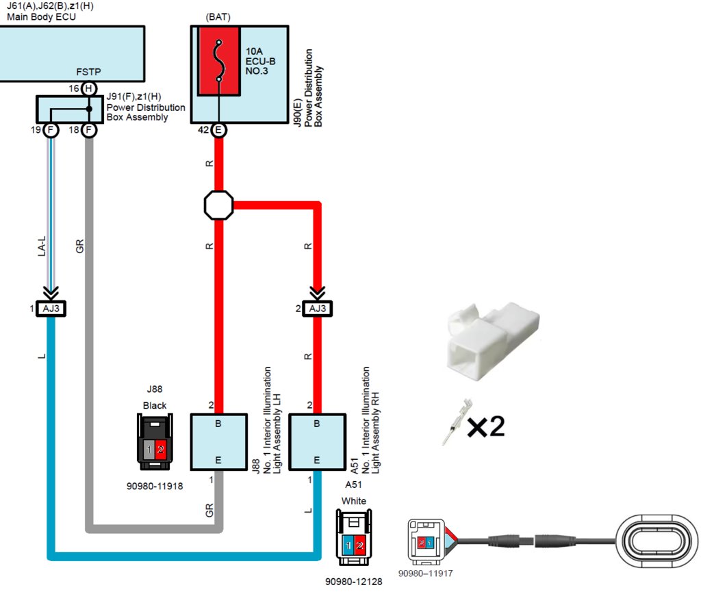

    Female side is on the vehicle.
    Purchase and assemble the male connector to mate with the tiny LED Lamp.

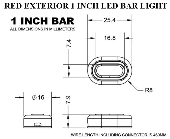

    Crimp the terminals to wire from the VLED 1" red LED.

    I'm no electrical engineer. I looked at your graphics a few times and I'm not sure what parts you swap out to change those lights. Do you have a name of a part or some type of instructions because all of that is pretty meaningless to a layman like myself. It looks like that bottom right hand corner LED is what can be swapped out but that doesnt really help me much.

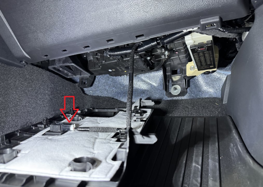

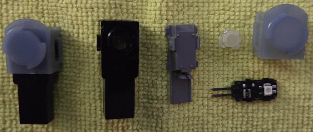

    Removing the original installed lamp and mating the new connector with cable allows you to change color (red) and have more footwell illumination.
