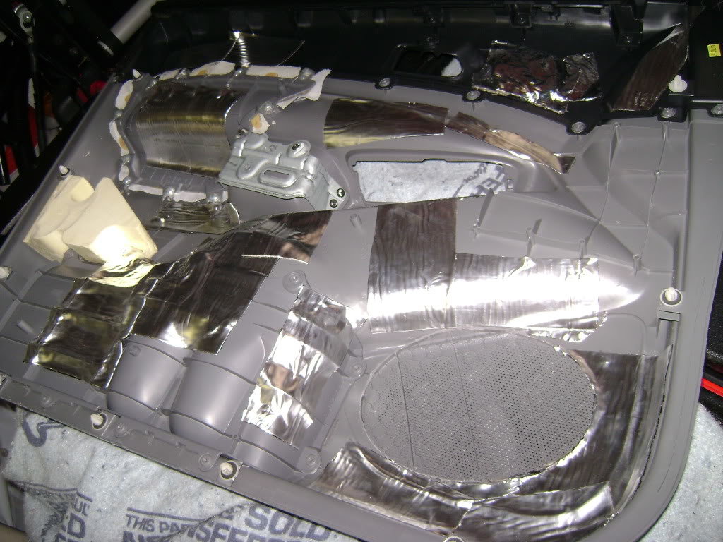

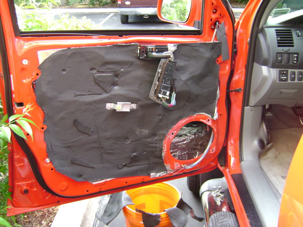

    Here is a door after removing a DLS and baffle

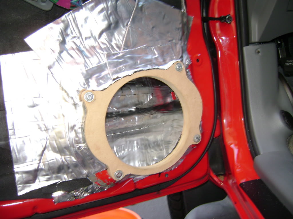

    Next I dry-fit the new baffle (without spacer) and marked the speaker opening needs to be enlarged for the 8" driver

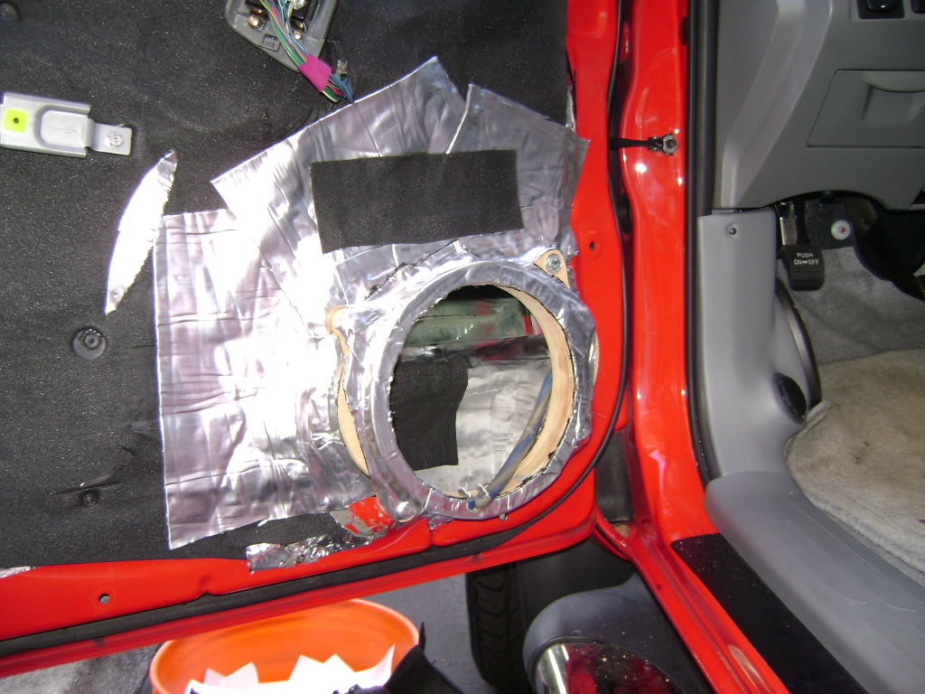

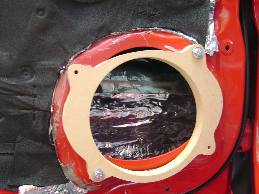

    Here is a pic after enlarging the hole, and installing the baffle (set in 1" butyl tape). I sealed the "gap" at the top of the baffle inside and out using the peel n seal. Trust me..its air tight!!
    I then installed the mdf spacer..set in butyl tape which seals it, and holds it in place while I work.

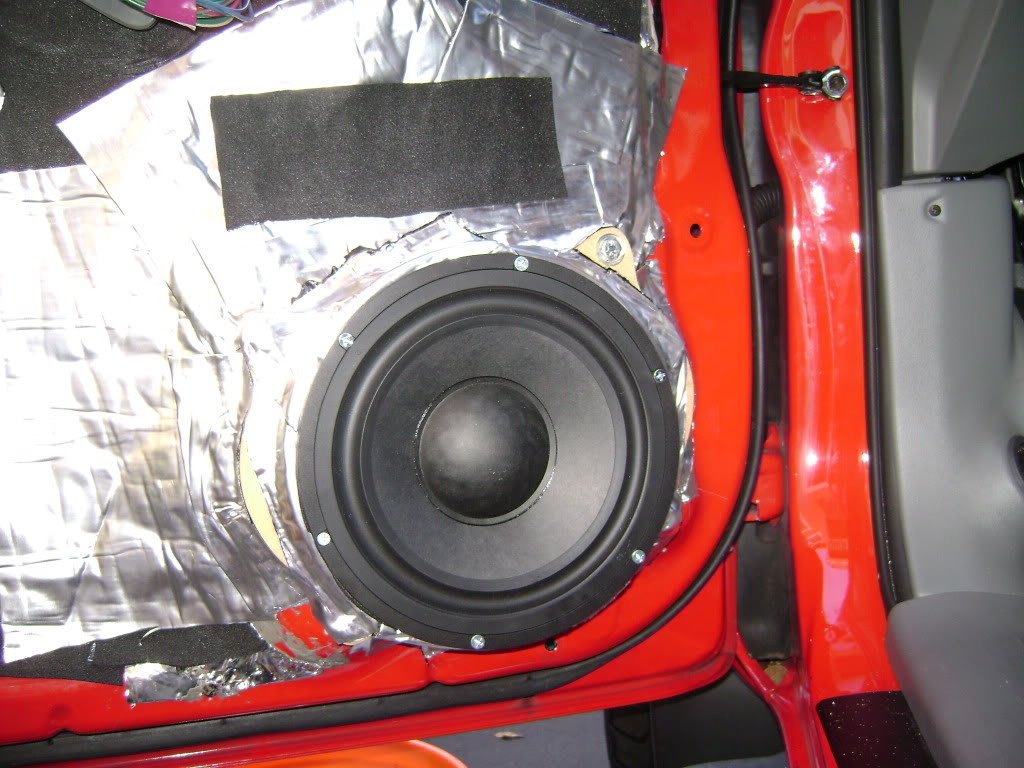

    Finally...the driver installed. I use weather stripping as gasket material on all my drivers.. 1/2" x 1/2" from home depot

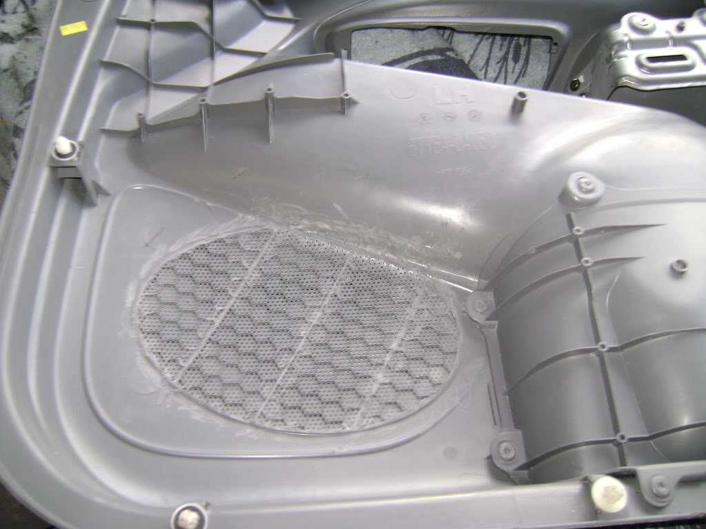

    I had already "shaved" the plastic door panel with a dremel when i installed the DLS...but took a little more to ensure clearance.
    I added peel n seal to the door panel for safe measure

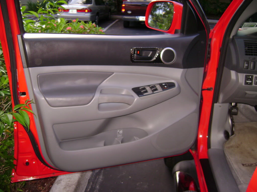

    The finished product
