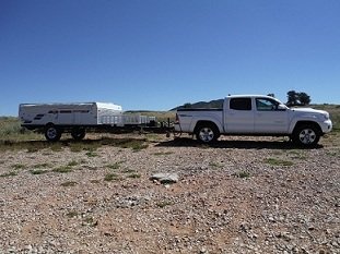

    I just started the whole towing thing myself. I purchased a used 2014 Starcraft RT 12, pop up toy hauler.
    I learned very quickly that there is a concern with tongue weight. Tacoma's are not set up for much of a tongue weight as most other class III equipped tow vehicles.
    The pop up is about 3300 or so, with a dry tongue weight of 450. That does not leave me much for the hauler part.
    Consider where most of the weight is going to be on your camper purchase. It's very doubtful that the tongue weight of a non toy hauler will ever be a issue if the hauler part is in the rear.
    When you start pressing tongue weights, then you get into load levelers etc....
    stay small and light if you can.
    I pulled the pop up from Denver to Pueblo and the Tacoma didn't indicate any issues with the 3300 or so, but I truly wouldn't want much more living in Colorado. If I ever load out the pop up and truck with a lot of gear, I can see that combo languishing up La Veta, WolfCreek, Monarch and others.

    This is a 2014 Starcraft RT 12. I maxed out the water, put a generator on the deck (100lbs) and that was about it.
    Previously the truck didn't balk with the trailer empty and dry, but it definitely noticed the water weight (350lb or so).
    I also had the bed loaded with some propane, some tool, fuel, food, etc...
    I would say I was close to 4K with trailer and gear. I haul it up to Lake DeWeese from Pueblo and the climb is 4600 to 8000 and most of it all in 20 miles.
    IMHO, the tongue weight is the biggest issue with the Tacos. They will pull, but will suffer if you start creeping up to the 5K range.
