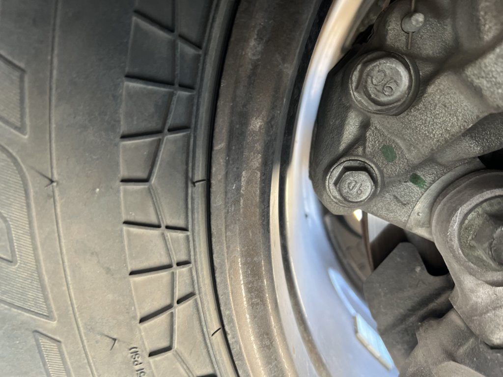

    Hey dudes - I put 17” wheels on my truck to fit lighter non-E load tires to keep weight down. But I’ve recently read that some folks are worried that the brake lines and brake calipers are too close to the wheel. On mine the line is about 1-1.5 inches away and the calipers are around 0.5” away. Nobody seems to have reported any real world issues (overheating, contact being made with brake components, debris messing things up). My setup is below:

    There seems to be enough clearance for everything from what I can see including the brake line (see photo) but I’m no expert. I’ll need to keep an eye on it. IMG_6416.jpg

    Looks like the line sits lower than the rotor or shield compared to the nonhybrid pictures I have seen but can't see enough to see if the lines is routed differently.

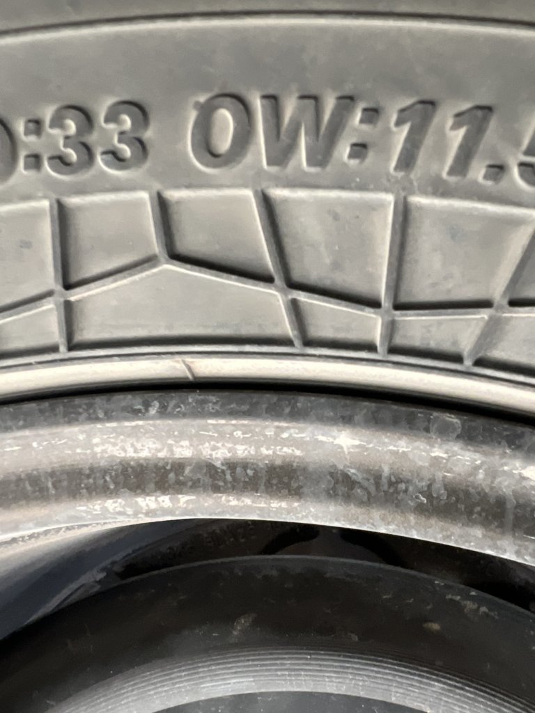

    Closest spot - it’s up high but rocks getting in there would suck IMG_6425.jpg
