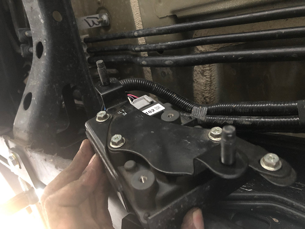

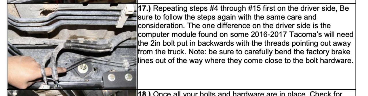

    On one of the steps for the driver side is removing a module and putting the 2in bolt backwards with the threads pointing out away from the truck.
    I do not want to destroy these bolts trying to get them out because they seem welded in.. any other solutions besides grinding at it? @Joe-Demello Offroad @JDEMELLO

    Sorry, you are close. The module doesn't get the bolts removed. Use the grade 8 bolt and put it in back wards. Opposite of the picture with the finger pointing to it. That way there is enough room to re-install the module. Give us a call if you have any questions 951-735-4417

    thanks. Kind of confusing since the sliders cover up the holes where the module mounts.
