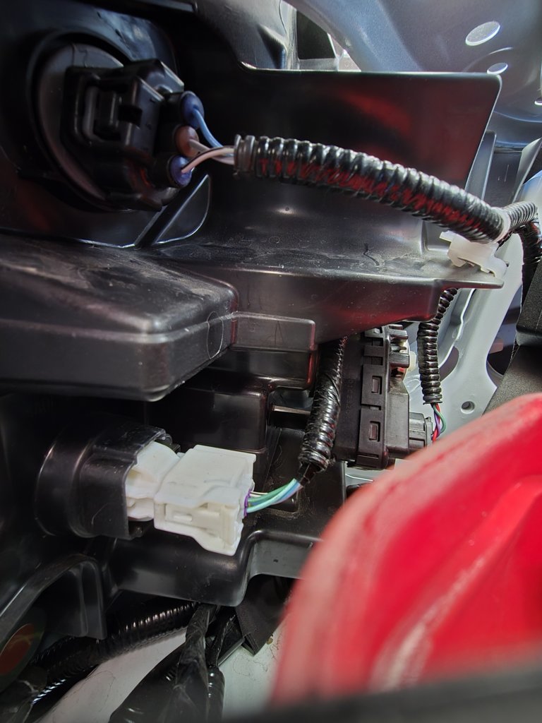

    I know about that one, I was referring to the white connector.

    Are you saying the bottom white connector is for low and high beams, and also turn signals?
    The top black is also for turn signals and for parking or DRL?

    That is the normal white connector to the LED headlamps. There is a black connector for the turn signals. Do you have two white connectors? I am a little confused. I see only one white connector per side in your photos?

    Only way to be positive is to verify juice with DMM and vehicle in various states of engagement. (Park, Neutral, Drive) and light switch position also.

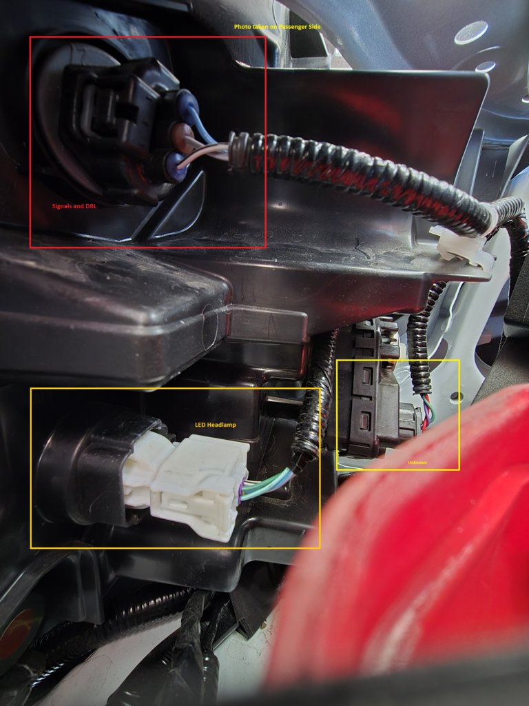

    I only have the 1 white connector in the middle of the photo which I will now assume is for the headlamps and the top 3 wire black connector is for the turn signals and I also believe DRL.
    I will be testing them out hot in the various states to verify soon.
    There is also a grey 3 wire connector with red, purple, and green wires in the center right of the photo which I believe also connects to the lamp assembly or something very close. Here I have it marked.

    Yes, that middle connector is a mystery to me...:confused:
