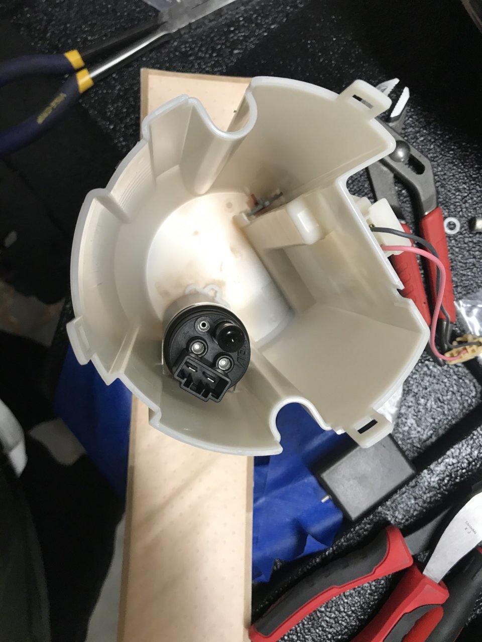

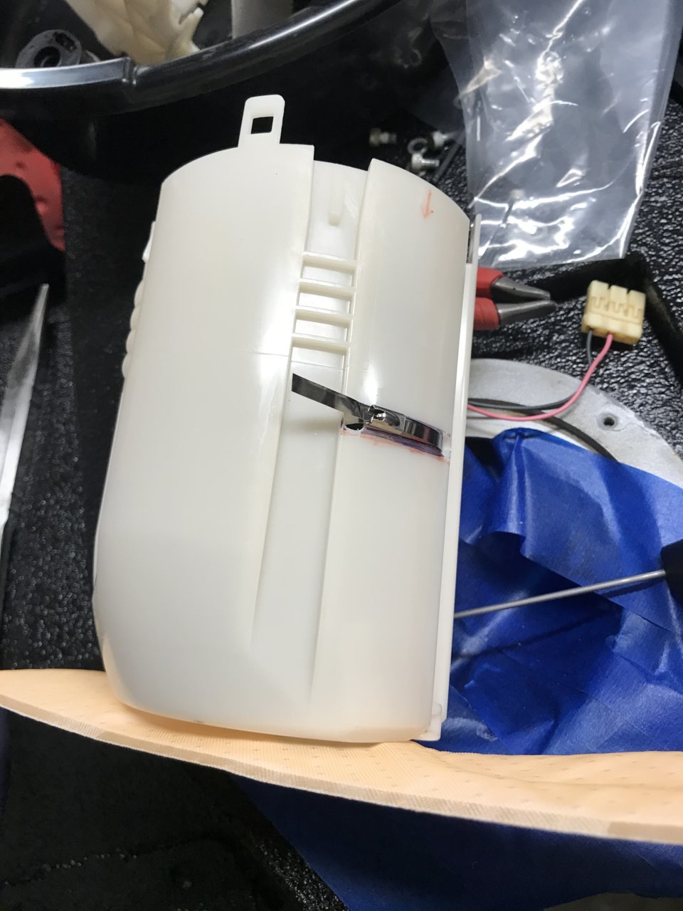

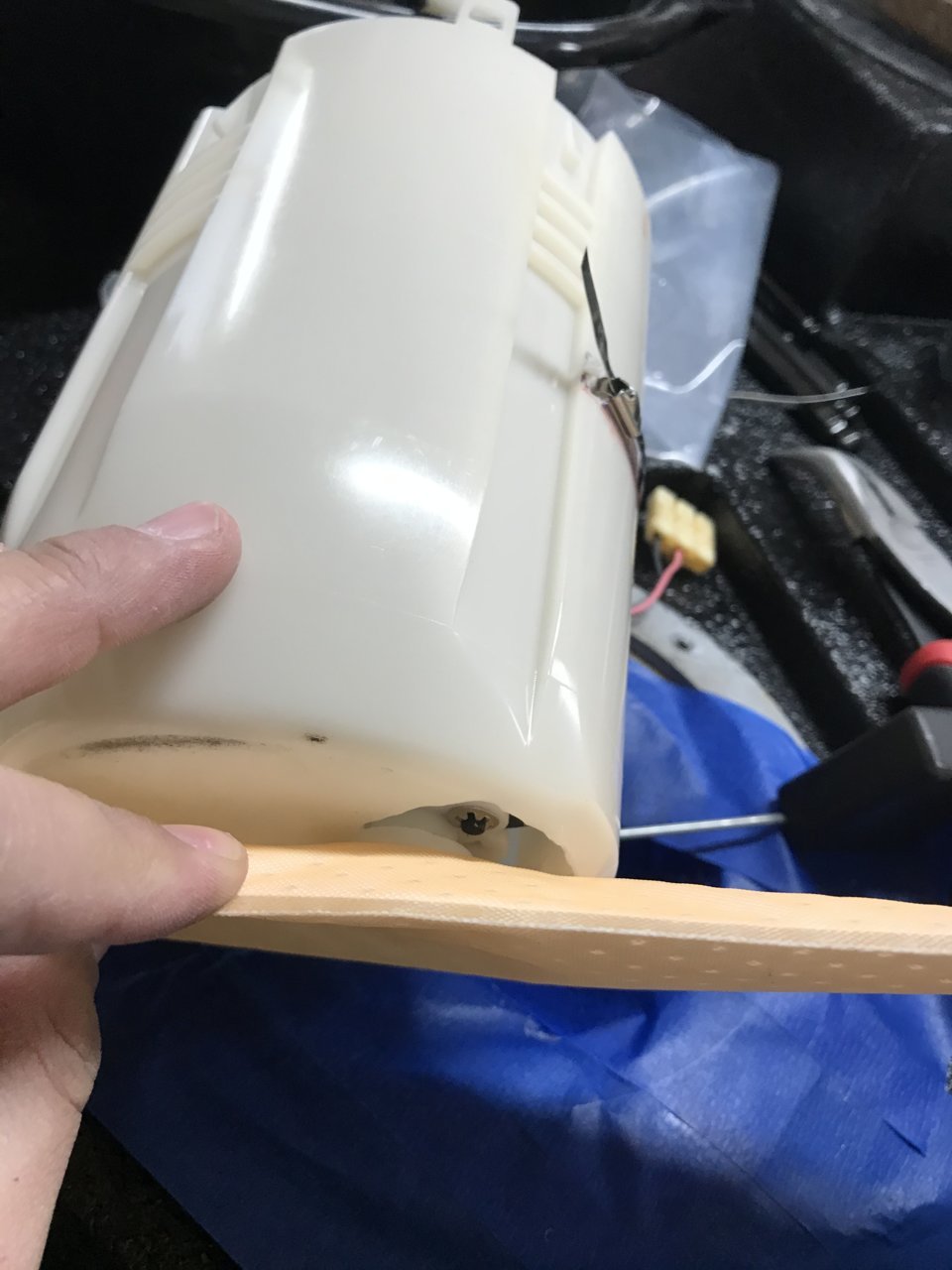

    Here’s my version of the install. Does having a hole in the bottom of the bucket cause any issues? @Torspd is this how you’re planning on installing it?
