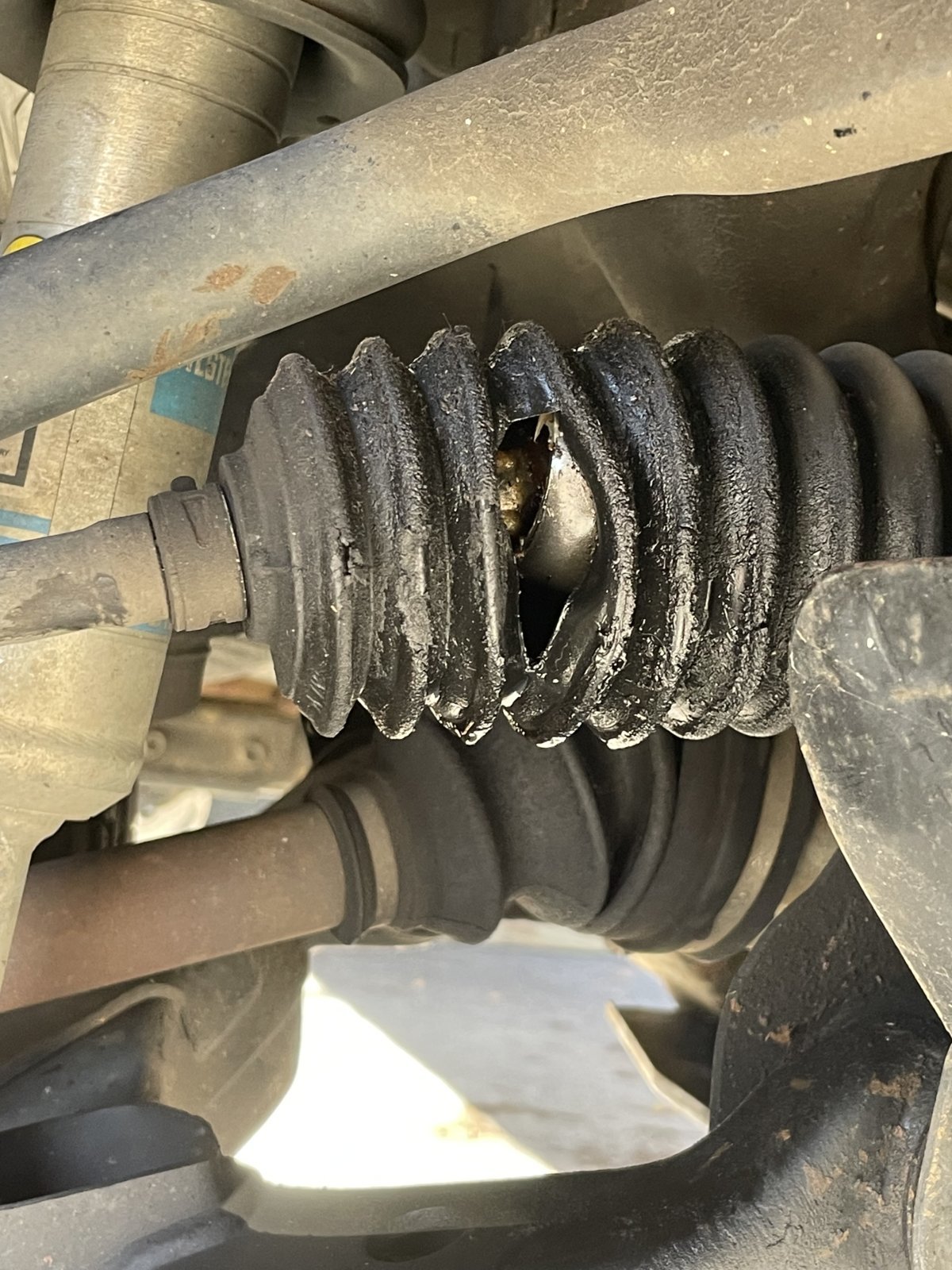

    Quick question. The control arm going into my rack in pinion I believe is popping. The boot has a hole it and I can see the joint inside. Is there a way to fix that end? The top end of the control arm? Without replacing the entire rack and pinion?

    That would be your inner tie rod end, if you're fine with aftermarket parts then yes you can get a new inner tie rod. Use a reputable brand though, maybe add a little extra grease to the joint before you install in and get an alignment after. Measure the length of the tie rod before replacement and afterwards to get it close for the drive to the alignment shop

    Dude that’s going to save me about $300! Thank you
