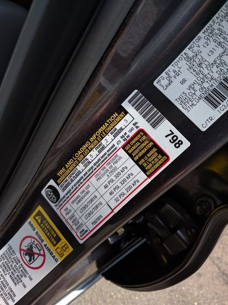

    Well, placard is 46 PSI for the Pro because it comes with LT tires. So 40 PSI can be entirely appropriate, even with stock size tires if they are LT instead of P.
    Which is to say your question is spot on! Inflation matters a lot, and what it should be matters on the tire size (including whether LT or not).

    No, that is incorrect, the 2014 and 2015 TRD Pro and Baja came with port installed LT (not P) BFG KO Tires, absolutely NOT the same as the P rated tires on the Off Road. The Pro and Baja also had port installed updated placards for 46 PSI (note the placard specifies LT).
    There was some discussion at the time that 46 PSI was still high, since if you compute from the load curves for LT vs P tires of that size you'd expect 40 PSI front and 43 PSI rear. One unsupported assertion was that this had something to do with the TPMS system, while others pointed out that the manufacturer is the one that determines the placard pressures based on a number of factors and the higher than expected pressure was due to suspension differences.
    Regardless, the Pro and Baja definitely had different tires than the Off Road and definitely had different placard pressures.

    He's got your answer right here:
    Yep, this is the correct answer. From my calculation spread sheet the LT265/70R16 equivalent points on the load curve are 40 PSI front and 43 PSI rear (i.e. same as the P curve at 29 and 32 PSI). (EDIT: Tried out the nifty linked calculator and it came up with 41 and 44 PSI - so my spreadsheet doesn't suck too much apparently - thanks for the helpful link!)
    So for the OP, if both tires are 265/70R16 but one tire is LT and one is P and you've got them both at 40 PSI that's part of your answer...
