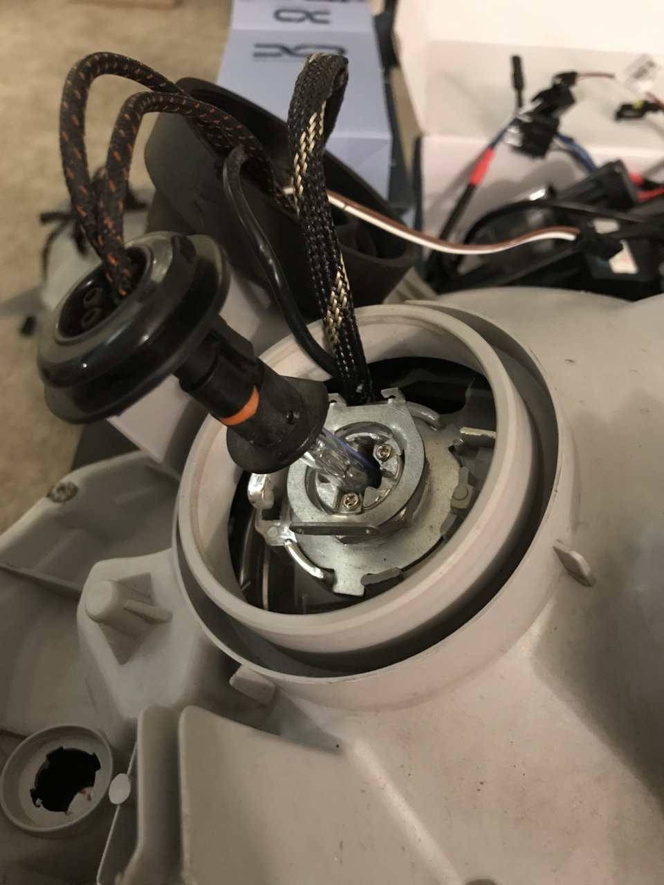

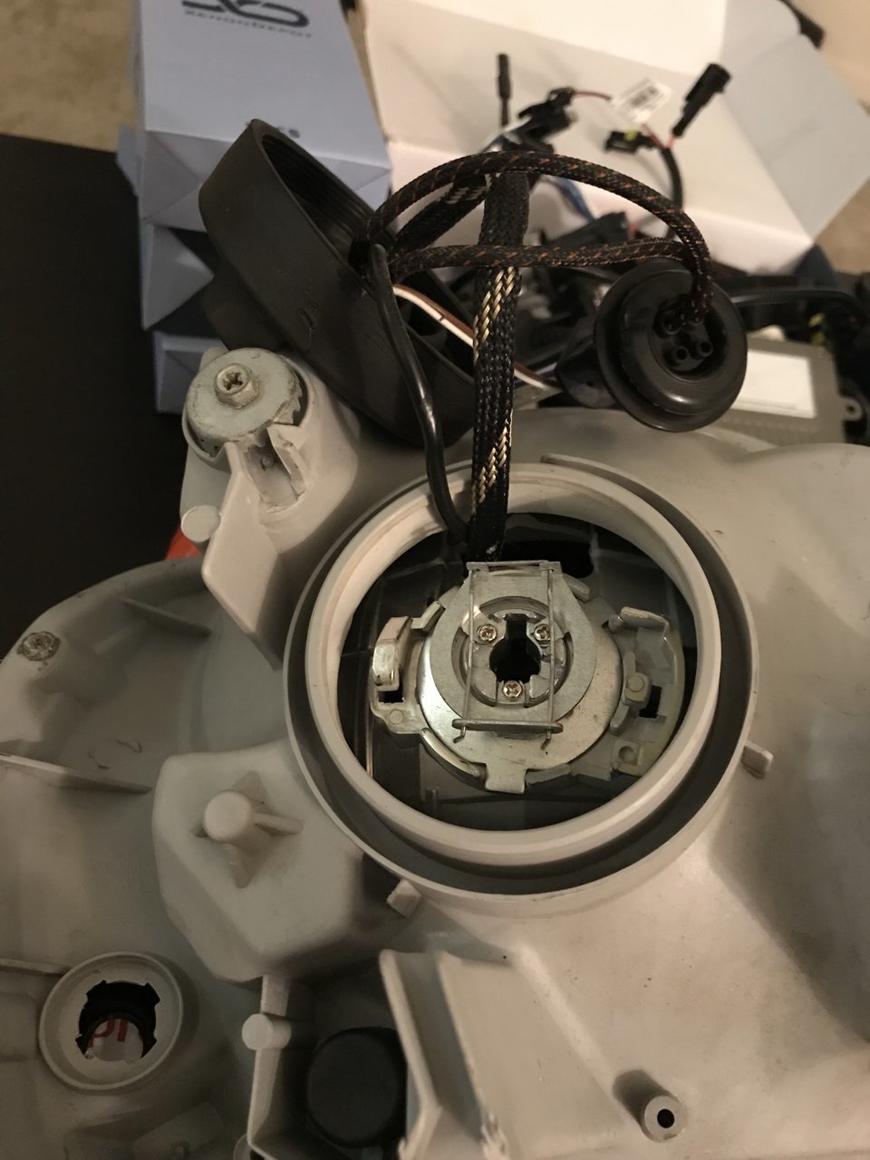

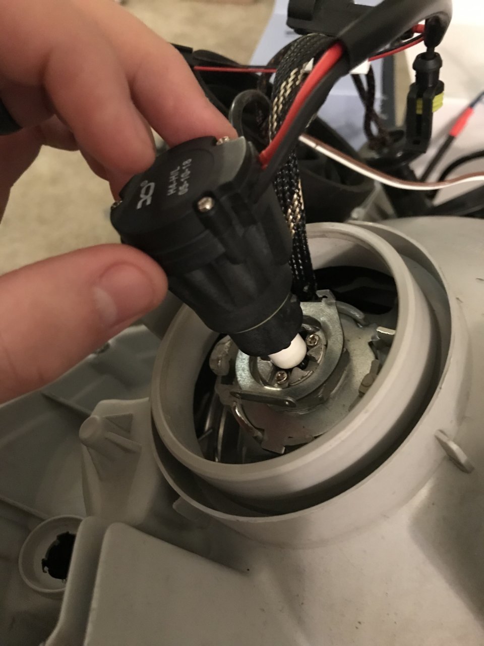

    I just bought a set of the Xenon Depot extreme HIDs for headlight housings that I previously had the Morimotos in.
    I’m finding now the xenon Depot bulbs aren’t compatible with the mounts for the morimotos...anyone see an easy fix or am I stuck with the morimoto bulbs for this particular retrofit?
    The white collar on the xenon Depot bulb won’t allow it to seat fully.

    What fitment did you get from XD?
    Looks like it says H4 on it. Do you have Morimoto Mini H1 projectors? Those lamps take H1 fitment bulbs.

    Wow. Good catch. The company that originally did the retrofit doesn't do them anymore so I can't be 100% sure, but it does look exactly like the morimoto mini H1s doesn't it. Looks like I'll have to send the H4 back and swap for some H1s. Thank you.
