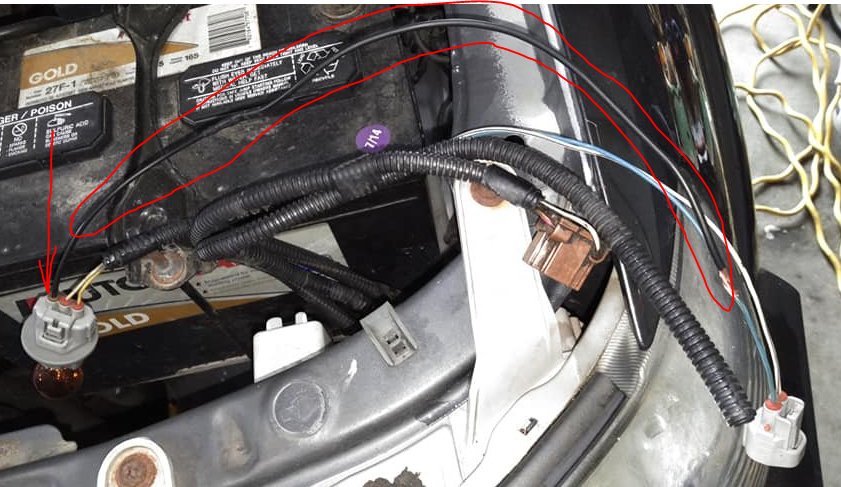

    I added the black wire. The hole in the plug (red arrow) had a blank rubber plug.

  12. Jan 14, 2022 at 7:32 AM
    Dm93
    Dm93 Test Don't Guess
    Mar 3, 2015
    #150066
    13,379
    Texas
    2014 DC OR 6spd 4x4
    Predator tube steps, Ranch Hand grill guard, Magnaflow CatBack exhaust, Toyota tool box & bed mat, 2LO Module by @Up2NoGood, Rearview Compass/Temp Mirror, Tune by @JustDSM.
    I think I'd swap the wire on that connector and see if it solves your issue.
