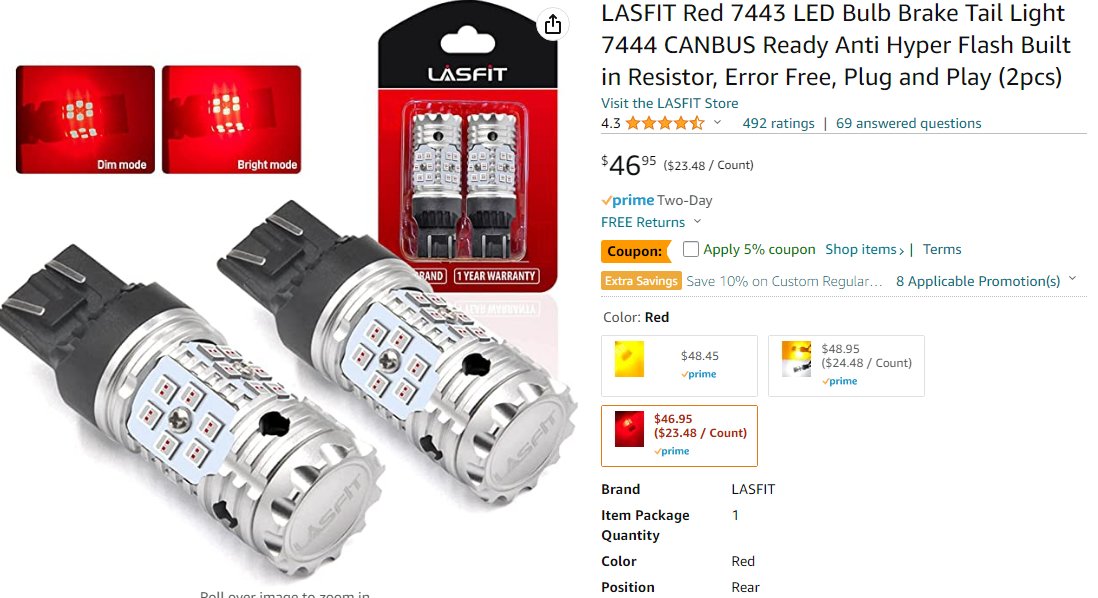

    Are they cheap bulbs? I tried to save money and bought shit-cheap ones and they hyper-flashed. Ended up buying these and no problems!

    For that price, might as well get the MESO total tails!
