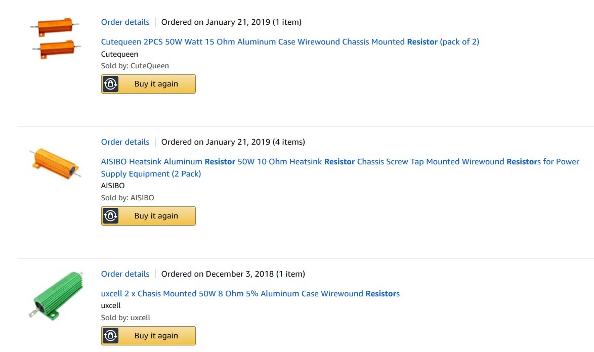

    As someone else mentioned, you may need more resistance in the circuit.
    Here is an image of my Amazon orders back when I was trying to mess around with LEDs before I bought a kit from MESO.
    See a pattern? I think the 15 Ohm resistors ended up solving my hyperflash issue, and I didn't have LEDs up front.

    Looks like your front turn signal bulb is a 25 watt 7440 bulb
    P=V^2 / R
    25 = 13.5* 13.5 /R
    R= 7.29 ohms.
    So, I might try a 10 or 15 to start with but be prepared to go lower.
