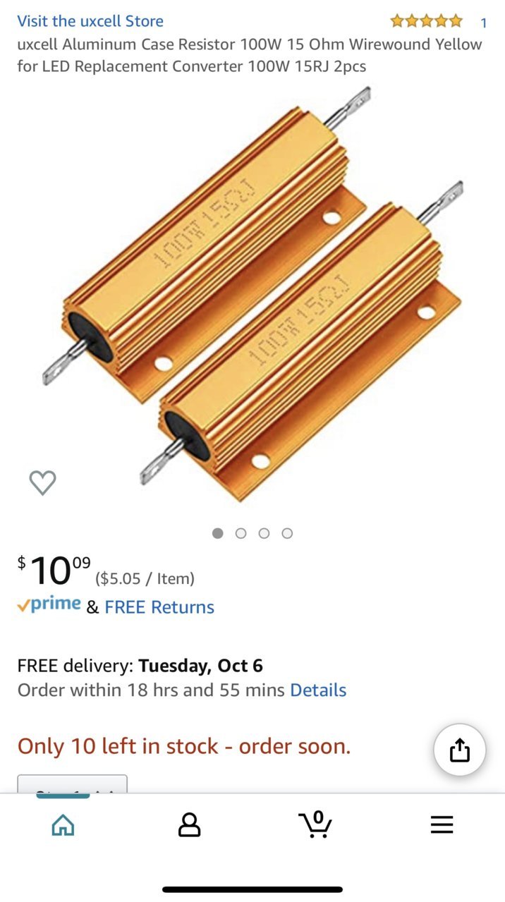

    What if I get this? It’s 100W 15ohms. Would one of these wired into one of the tail lights fix the complete circuit?

    Op you really need to find out the original wattage of all the lights so you know the load that thev system is looking for.
    To much resistance will net the same result as too little.
    You said you swapped all the bulbs back to stock and it still hyper flashed?
    Maybe you have a bad splice somewhere adding resistance to the system

    Front turn 25W each LED = 6.5W
    Rear turn 25W LED = 3W
    Rear brake 25W LED = 3W
    Reverse 18W LED = 5W
    Total = 93W LED Total = 17.5W
    Difference = 75.5W
    Thoughts?
