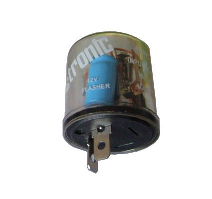

    On my Corolla, I used an electronic flasher. It isn't load dependent so no hyperflash.
