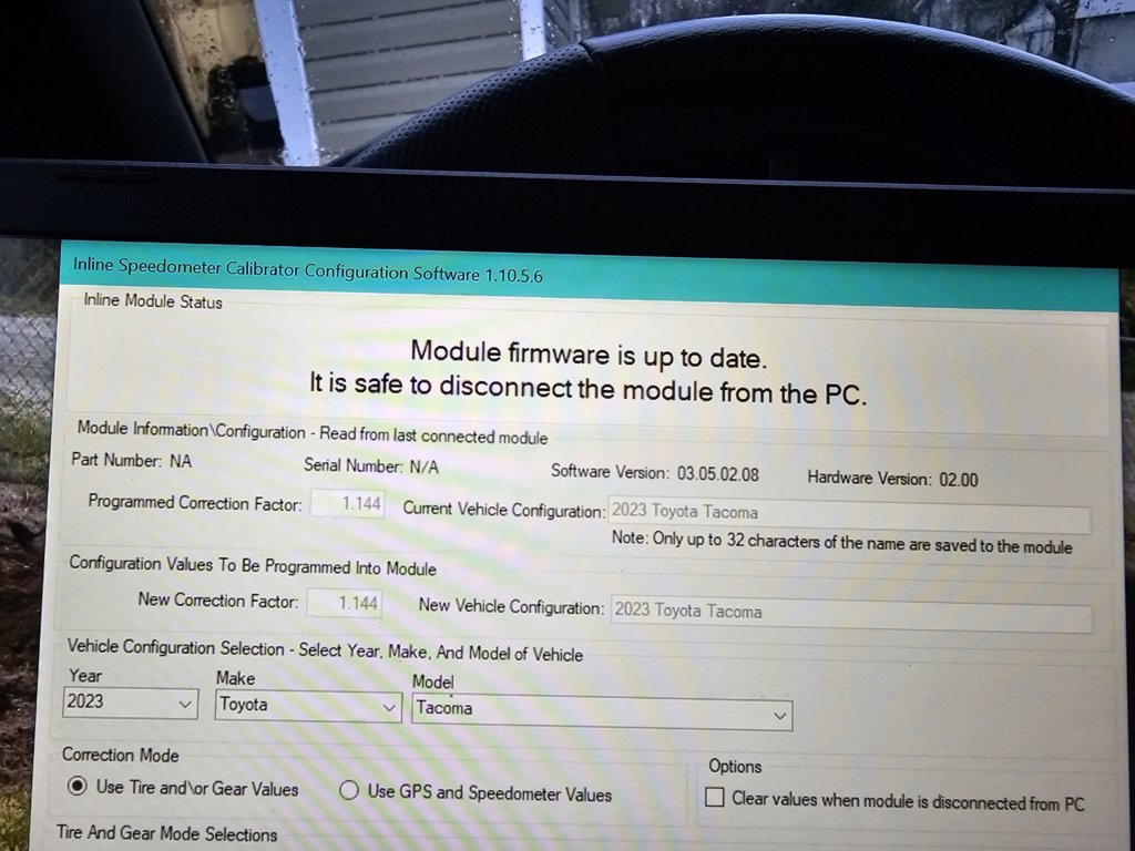

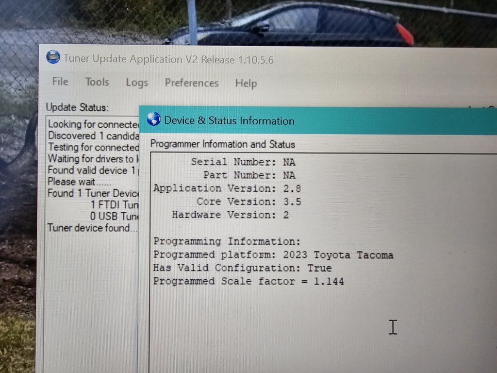

    been waiting all week for a reply from hypertech but nothing yet... see if anybody here knows what to try.
    bought 730123 calibrator for 2023 toyota tacoma.
    module software version 03.05.02.08
    configurator software 1.10.5.6
    no matter what parameters i put in whether a change in tire size or gps speed it does not affect the speedometer on the truck. with my 35s it reads 10% lower than speedometer speed. something i dont know about or is the unit defective?

    Can you find/try the previous firmware rev? I was on 1.10.5.56 when I last used mine and it went through without a hitch.

    dont think its possible.

    Just out of curiosity, but are you trying to program the tuner while it is plugged into your truck?

    On my 2019 I had to put in that the truck was a 2018. I just went through hell after jumping up from 33’s to 35’s to figure it out. Try putting in that your truck is a 22 and see if that works.

    at first yes. then tried programming on the truck. done nothing in either case

    2023 is an option. but i even tried changing to other years. nothing changed

    If you try to program it when connected to the truck it will default the settings.
    Here is my configuration: The actual stock tire size is 265/70r16. This always head the speedo about 2 mph under over what I was actually going. I ran 265/75r16 and the speedo matched up perfectly too gps. I first programmed the tuner with 265/70r16 and the speedo was displaying a speed 2 mph over the actual speed, so this time I am programming it with the 265/75r16 so the speed is once again accurate. I didn't program the gears. If I doo it drops the correction factor to .078, which is way off.
    If none of the settings work, I would double check the wiring to make sure everything is secure.
