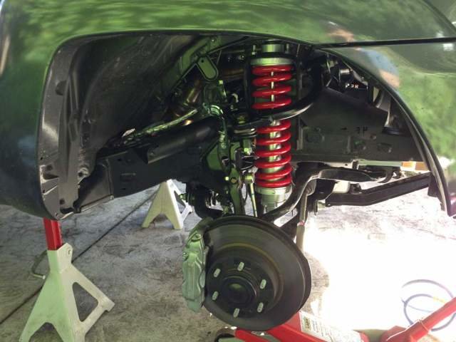

    I finally installed my ToyTec ULK, LR UCAs, and Dakars today. I pulled the truck into the driveway at noon (got home @ 5am from my night shift). And it took me about 9 hours to do it, not including a run to the store to pick up a 32mm socket for the new ball joints & a meal break. It was all very easy, just a lot to do.
    I still need to adjust the bilsteins another inch to get my full 3" of lift. It looks like I got a 2 1/2" lift from the Dakars.

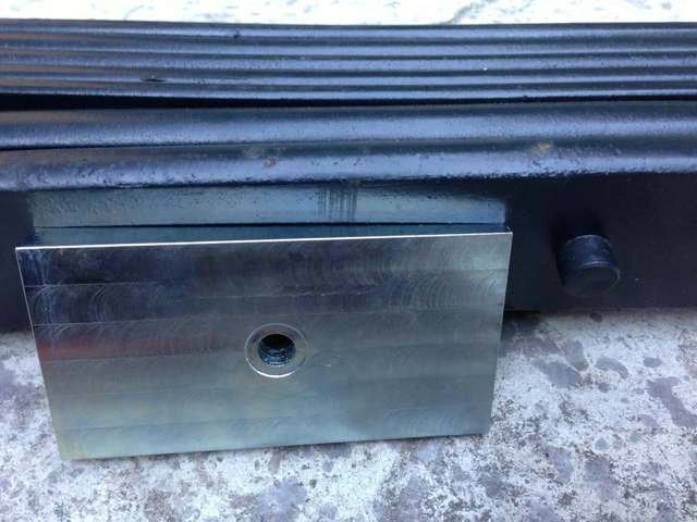

    My kit came with 3* axle shims, but they were wrong. The hole was too small for the center pins & the pins were too short anyway. So I skipped them.
    This just not gonna work! EDIT: OZ educated me. These are supposed to bolt onto the springs with the center pin.

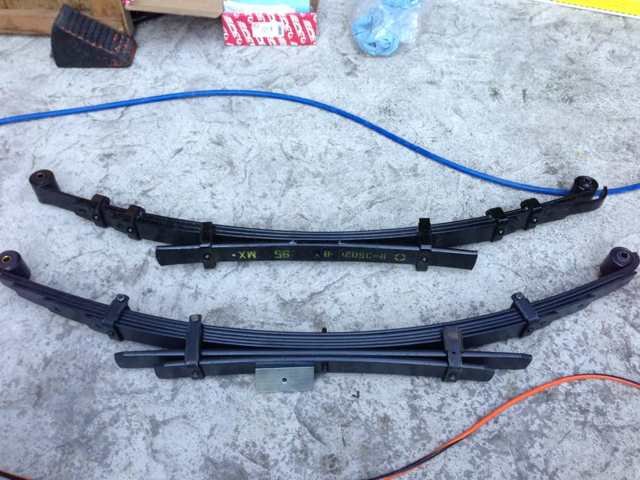

    Dakar next to the stock Sport spring

    I'm also wondering, what do you plan to do with the tsb 4 leaf you took off?

    I haven't decided yet about the leafs. I'll probably sell them eventually.

    Haha. They don't understand never will. Here's my lift results:
    Front
    coil-overs adjusted for 3" lift
    Hub center - wheel well 23"
    Rear
    Dakar leafs gave about 2 1/2" lift
    Hub center - wheel well 24 1/2"
    Frame clearance measured on alignment rack @ cab & bed mounts
    Front: 17"
    Rear: 17 1/2"
    This gives me 1/2" of rake based on the truck frame.
    I might lower the front a little - I'll wait and see. I got a 3yr alignment package from Goodyear, so I can go in as often as I like.
