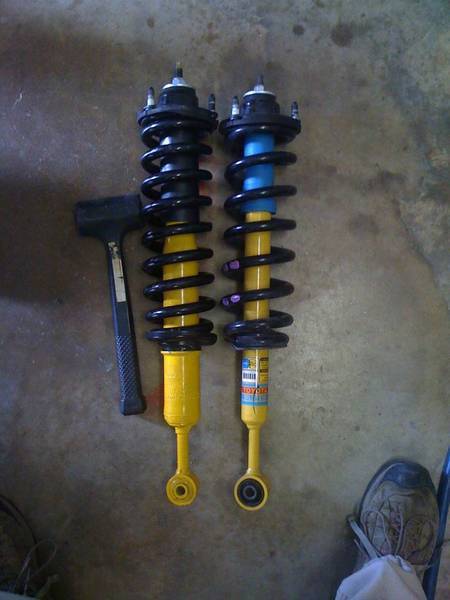

    N140S are Nitrochargers. N90000 are Nitrocharger Sports. They have the same extended length but the Sports have a longer collapsed length. And that does not look like it is an inch shorter shorter than stock.
    Here is a 5100 next to factory Bilstein.
    Note the spacer lift on the original Bilstein assembly.
    Here is what I'm thinking... my shock I thought was the factory shock is not. But the OME is still way shorter than a 5100 and there would be no negatives to running a 1/2" spacer on OME N140S.

    So it looks like both the Nirtochargers and the 5100's are a little bit longer extended than stock billies. The issue in question now becomes collapsed length.

    Stock Billies have 5.07" stroke. 5100s have 5.53" stroke. OME N140S have 5.43" stroke. Collapsed lengths between 5100 and N140S should be similar enough to be irrelevant (i.e. bumpstops hit before shocks bottoming).

    So that should settle it... The shocks themselves (extended) are a little longer and have a longer stroke so you don't lose any travel range.

    Didn't you just look at the pic of a 5100 being similar length as stock plus spacer?
    Also I'm saying the 140S plus 1/2" spacer won't collapse to closed before hitting the bumpstop... and it gives a half inch more extended shock droop for more travel, especially if you have a Uniball UCA.

    It's interesting. The 5100 appears to be as long as Icon Extended Travel coilovers, which are advertised to require uniball UCAs to reach full droop.
