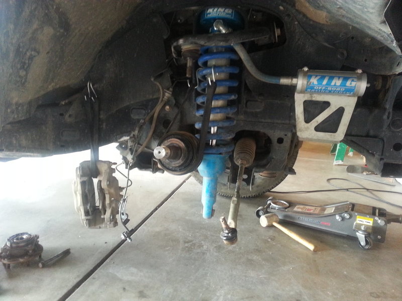

    Did a whole bunch of work to the truck today....
    A bent spindle on the trail turned into:
    • New (used) gusseted spindles
    • New tie rods
    • New (used) UCAs
    • and since I was that deep into things, I decided to pull the LCAs and clean up the cam bolts/sleeves
    Left the axles in and the coilovers hanging from the top mount and that's about it.
    Felt like I was a little bit of cutting and grinding away from a SAS :rolleyes:
    As far as alignment goes, I put the upper ball joint one step forward which I understand should be 1 degree caster over stock UCAs. I also pulled the upper ball joint to it's furthest out position (camber)
    On the cam bolts, on the advice of @lotsoftoys I started with the rear bolts outboard and the front bolts down.
    I just tried to make the tie rods have even threads showing. I figure tomorrow I'll get some help and do a tape measure toe adjustment. Hopefully that should get everything good enough to make it down to the alignment shop.
