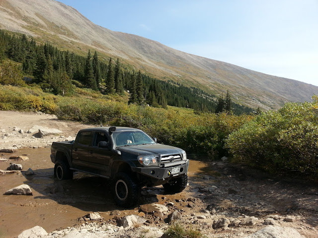

    Added another trail to the list today...
    One I've been wanting to hit for a while. Wheeler Lake
    Pictures HERE

  16. Sep 14, 2015 at 1:23 PM
    #276
    Crom
    Crom Super-Deluxe Member
    Jun 22, 2009
    #18782
    9,654
    Nick
    San Diego, CA
    2009 4x4 DCSB Camp Supreme
    Millions
    Looks like a fun trip!
    :D My favorite in the bunch is this one:
    And love the 3-rigs pictured in front of the lake.
    You got some awesome terrain out there in Colorado.
    Thanks for sharing.
