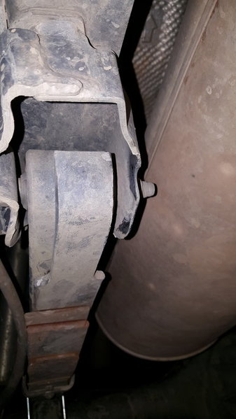

    When I first built my bastard pack the stock Ubolts were just long enough to expose a single thread outside the nut after removing the washers (which became my brake line extensions:D)
    I had thoughts of throwing the overload back in because it has the "fence" to keep the leafs aligned and a place to bolt the ebrake lines.
    I don't think the flip kit has a whole lot of advantages as my stock plates are only scratched up a little but I figured as long as I had to buy new ubolts, I may as well get a flip kit.
    I still haven't put the overloads back in and I don't think I will.
    The passenger side leaves have been starting to spread on me, but I just ordered some of these instead
    http://www.amazon.com/gp/product/B003EP2PIS?psc=1&redirect=true&ref_=oh_aui_detailpage_o00_s00

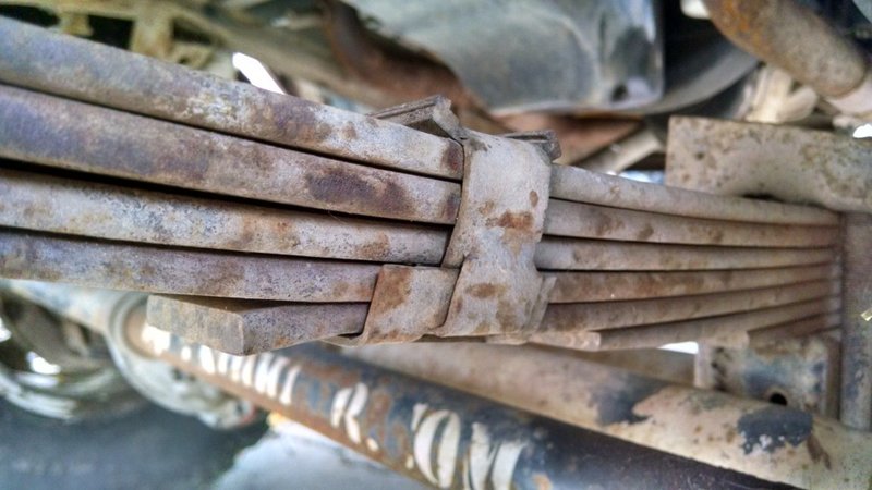

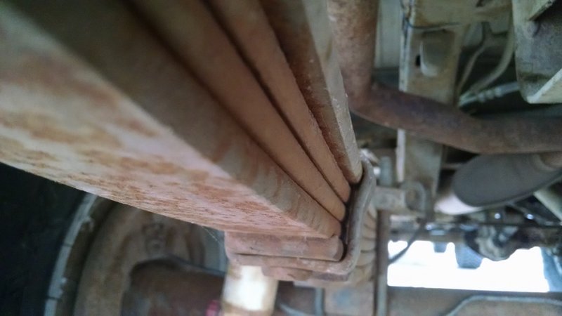

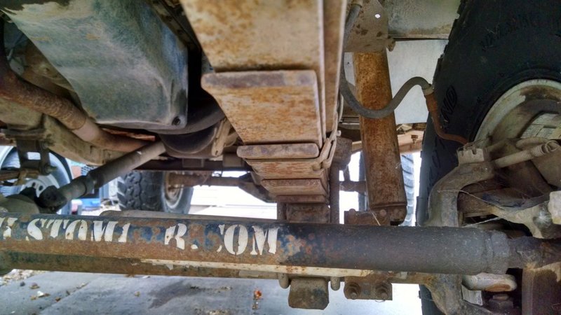

    So you clamp the leaf pack tight, and hammer the retainer tight, then clamp the retainer tight. Tight, tight, tight. Then weld the tabs. The rubber piece in the top helps keep it in place.
    Eventually, you'll want to go off road and that leads to pack flex, which just beats the retainer in to submission.
    This one likes to hang out near the shackle. Notice the not so square angle it was left with. Also notice the tiny tack weld on the bottom edge, in an attempt to keep it in place.

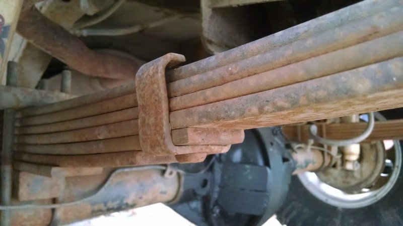

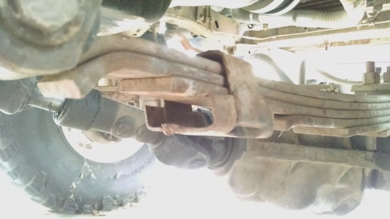

    This guy is stout, riveted to the leaf, but only folded over on top, no bolt through the ends
    and the flex of the pack still had it's way with it.

    A little misalignment won't bother me but the partial wrap on the second leaf was contacting the spring perch.
    You can kind of see where it was rubbing on the right side of this picture before I mostly straightened them out.
