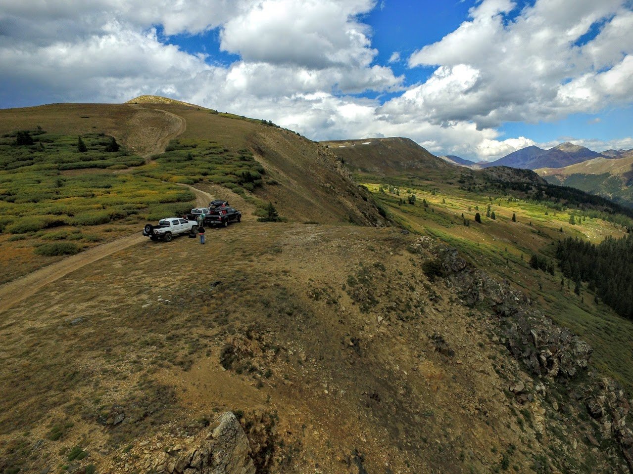

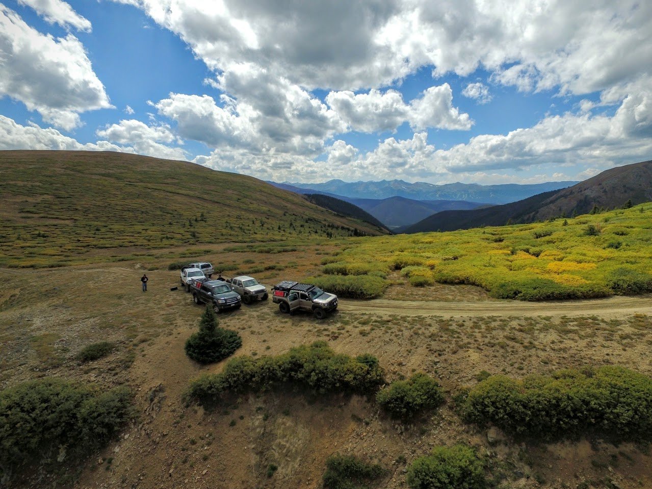

    Found a new favorite route out after running Redcone/Radical Hill.
    I consider it the northern version of the Alpine loop :D

    Amazing view.

    ^This! Wow

    What's this new route? Just back towards I 70?

    Yeah. In the past, I've either gone straight down to Montezuma or north back to 285. This still goes to Montezuma, it just traverses some of the mountain ranges first.

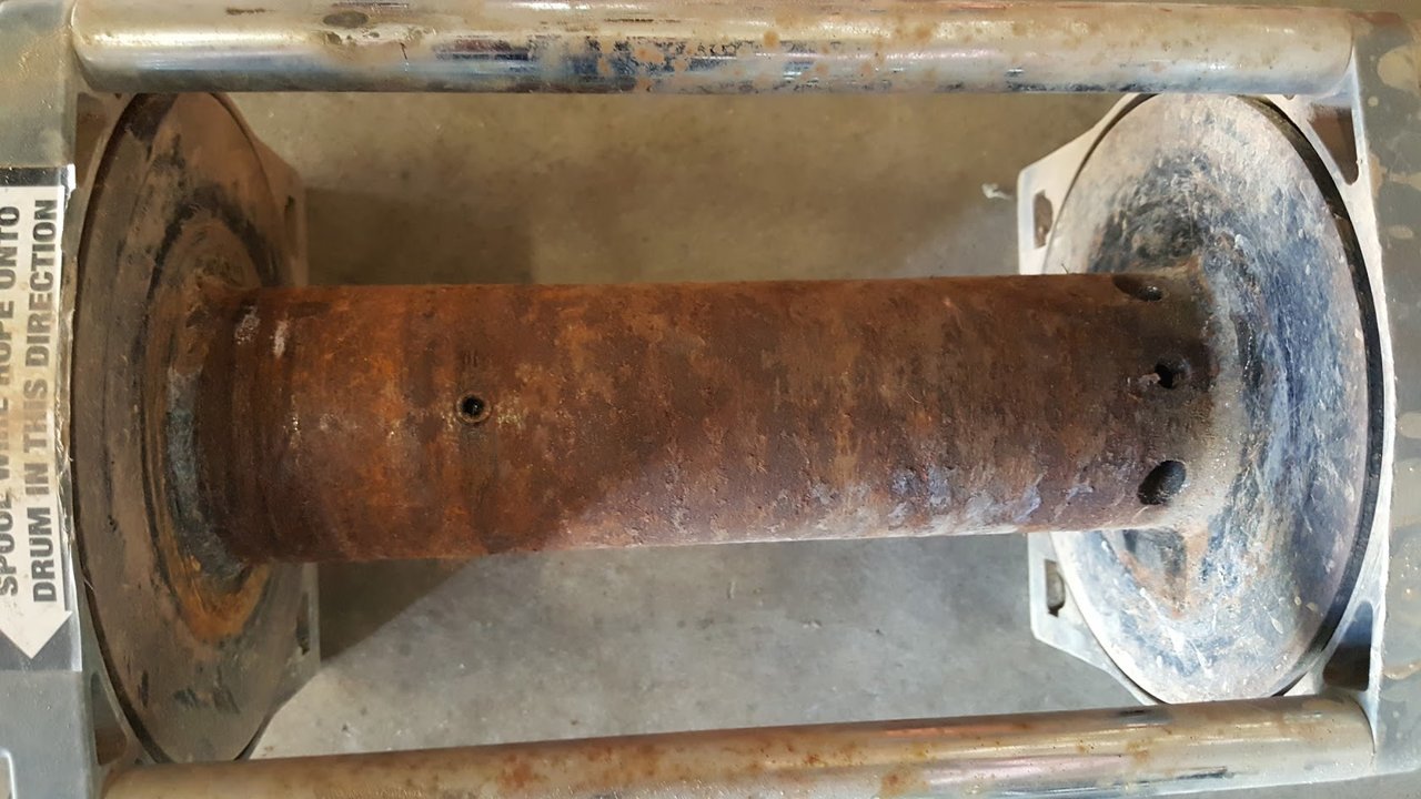

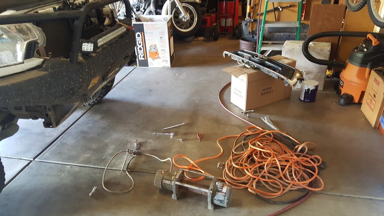

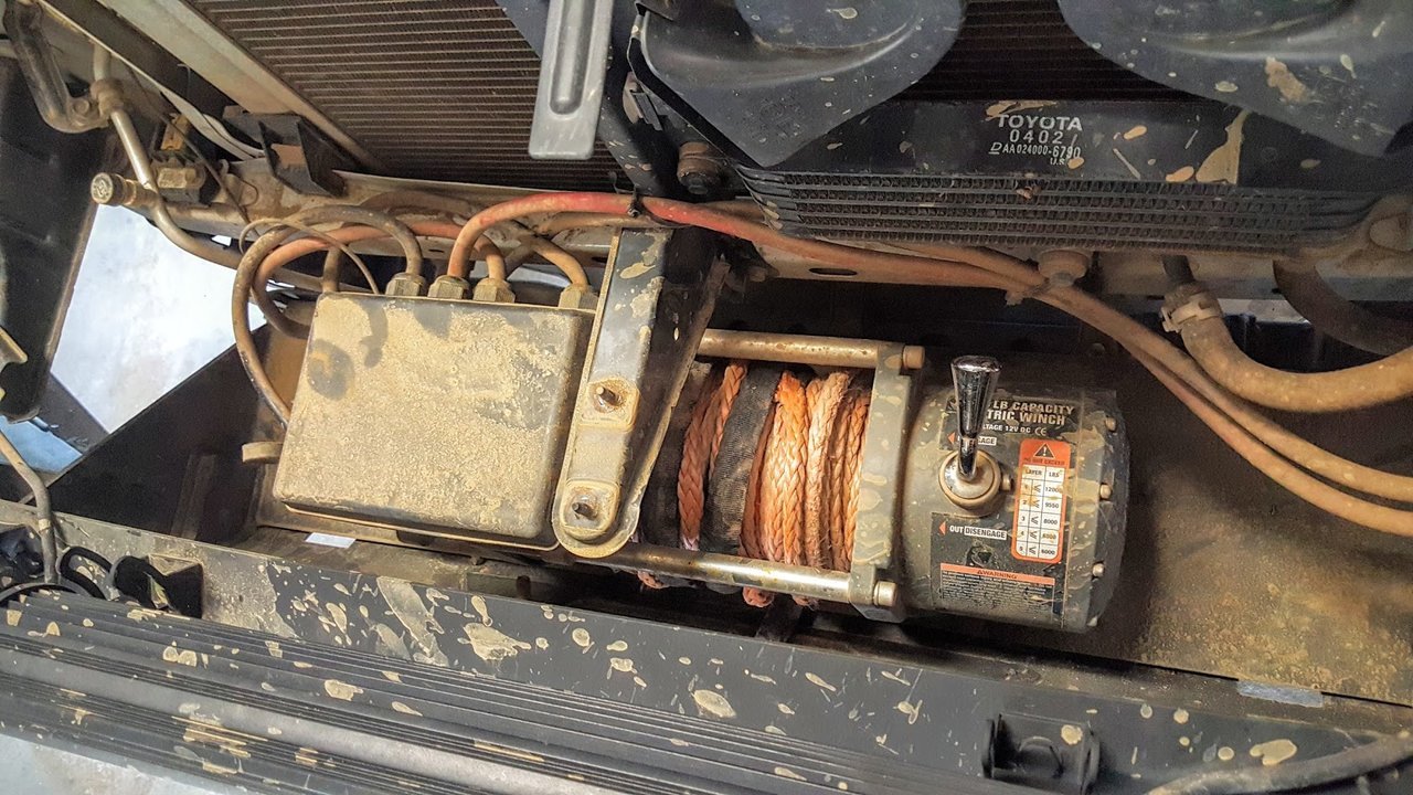

    Had to look back in this thread to find out how long I'd had my front bumper and therefore, how long the winch had been sitting in there untouched and neglected.
    Looks like it has been a little better than 3 years. When I got the bumper, I bought a $299 Badlands 12,000lb winch.
    Now many many people (who have never had one) will tell you what a worthless piece of equipment these winches are. After all, they're from Harbor Freight so they must be junk right?
    I must have lucked out big time because the winch went into the bumper before the bumper was mounted and hasn't been out since. In all that time, I've used it for countless pulls to recover my truck and other's. Never once has it failed me.
    Having run out of major modifications to do to the truck and with a thought for maintenance, I decided that the winch needed a little bit of love.
    I was able to access it without removing the bumper.
    Ao2-U9xD4cGx7_adx2IMRXDohskVAl9BcWfjG1wy_f12eeb60d213d9a1edcde61715f07d6d8b8dcc2b.jpg

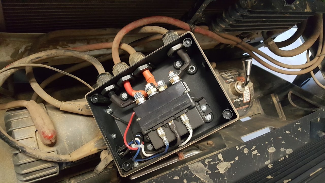

    Before removing it, I thought I'd check out the solenoid. It's been submerged several times and absolutely covered in mud so I honestly figured it would need some cleaning and sealing.
    Nope. Clean as a whistle.
    CALXzqtb_b1kqlYnmFF5LgKZvmw5Ezb3Kp1-tlKg_f35507a401eb8eb2305bfd78319d863a80e4876a.jpg
    SgPRgjd3pC6K6yyyClI42ExtMRNl7Zhb9nOrAeVa_19a6163a63bb2e5ef73825ad0e0bddb21dabf816.jpg
    I did switch to a synthetic line at some point. I think the synthetic is really bad about trapping moisture because the drum is in much worse condition than it was when I made the switch.
    Ub1SM_CP3qS5UKgHtPjzAbrxzxsuuP3s0L2lSlOm_51adc9ccd4ea2dda6fb924f35fb39f7ef6d292eb.jpg
    I figure I'll take the winch apart to clean and regrease it and I'll probably sandblast and repaint the drum. Might have to look around this site and google a bit to see what others have done to recondition a winch drum.

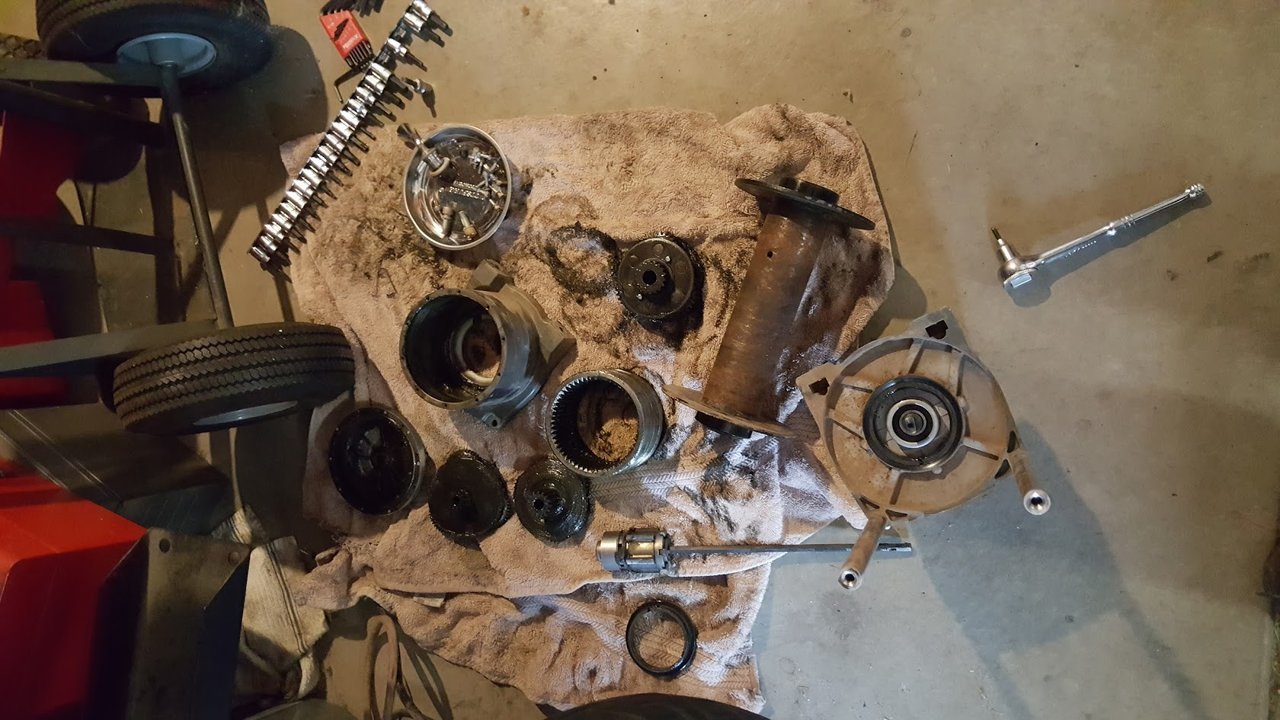

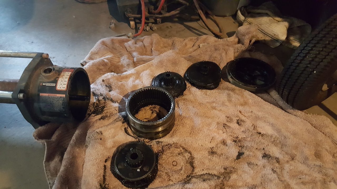

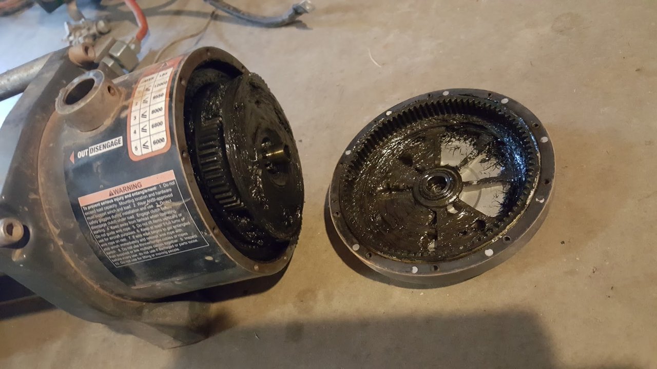

    2008 TRD AC 4th gen Rav4 Platinum
    ICONS Front & extended Rears DAKARS LR UCAS Wheelers Super Bumps F/R Homersoshi & Bumper insert, Ultra Gauge, Wet Okole seat covers, AFE air filter, Truxedo tonneau cover, LED White Cluster swap by yosh2000, Audio upgrade, ECGS Bushing, rcbs204 Lighted 4x4switch, Bullaculla trailer harness relocate bracket SOS Concepts IFS skid & sliders Anti- Dark RedLine Hood Struts Matt Gecko Bed Lights BHLM Depo Tailights Fog light anytime mod ABS cancel mod Rear diff breather mod Brake light 35watt mod Relentless u bolt flip Mobtown Recovery Bar Sound deadener doors rear wall
    :spy: I saw them too :)
    teamhypoxia[OP] likes this.
  17. Sep 11, 2016 at 5:01 PM
    #617
    teamhypoxia
    teamhypoxia [OP] MichelinMan
    Aug 21, 2012
    #85247
    9,706
    Colorado
    '12 DCSB TRD OR
    It'll be interesting to see if I can put this thing back together when it's time :D
    Gear side had what I typically think of as grease. Black and greasy, it did not appear to have been contaminated at all.
    Motor side has some "dry" grease... maybe graphite based? It's the contraption on a stick at the bottom of one of these pictures. Maybe it has to do with the brake?

    Yeah I used it to clean off my barbecue er. It's a messy job without a cabin. Shit flys every ware. How bad is the drum pitted? If it can't be wire wheeled then I can get the drum from you and blast it at work. I still have some sand left over from my project. You don't want to blast it at your place with out a cabin. The results are awesome. Way better then any wheel I've used.
  20. Sep 11, 2016 at 6:23 PM
    #620
    teamhypoxia
    Aug 21, 2012
    #85247
    9,706
    Colorado
    '12 DCSB TRD OR
    It's pretty bad... not sure a wire wheel would cut it.
    There's a sandblaster at the shop at work too. I don't know if that one would work or not. Apparently, it needs to be hooked up to one of those monster trailer compressors and there's this hood/hazmat suit thing you wear to use it .:rofl: Might be overkill.
    I'm contemplating lining the drum with gaffer's tape... The brake on this winch is mechanical so I don't think the drum gets hot or anything.
