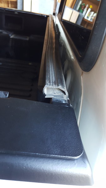

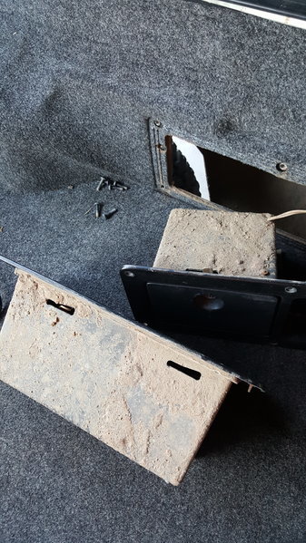

    I never really cared for the way the sides of the bedrug fit (or rather, didn't fit) so I think I'm done with it. The bottom part detaches from the sides so I think I'll keep it as a bed mat. What a mess!
    Hey @Crom I know you went on a major quest to stop dust intrusion into your covered bed.... what did you do about the cubby latches?

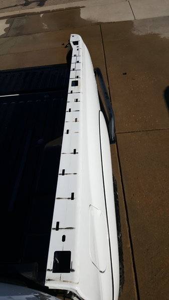

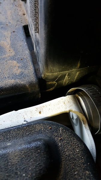

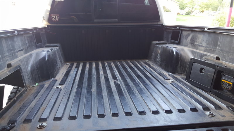

    Sure enough... these are the little cracks people talk about from bedside flex.
    They're just barely forming but it reinforces (pun intended) my thoughts about getting the bedside stiffeners.

    I pulled them cleaned them, put gorilla tape over there holes, top and bottom, used silicone to make a seal and reinstall. I left the doors off. A closed cell foam will work well too if right sized, in lieu of silicone.
    Here is a link to my full writeup, multiple links in the post too details about each cubby.
    https://www.tacomaworld.com/threads...d-and-adventures.362772/page-44#post-11379261
    I'd get the gussets for the bedsides.

    It really is ridiculous how bad the damage is...
    This is all cleaned up. No dirt. All the marks you see are missing paint.

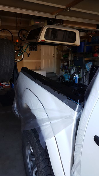

    Managed a pretty clean line.
    I think it'll look ok.

    That turned out great Eric. Nicely done!

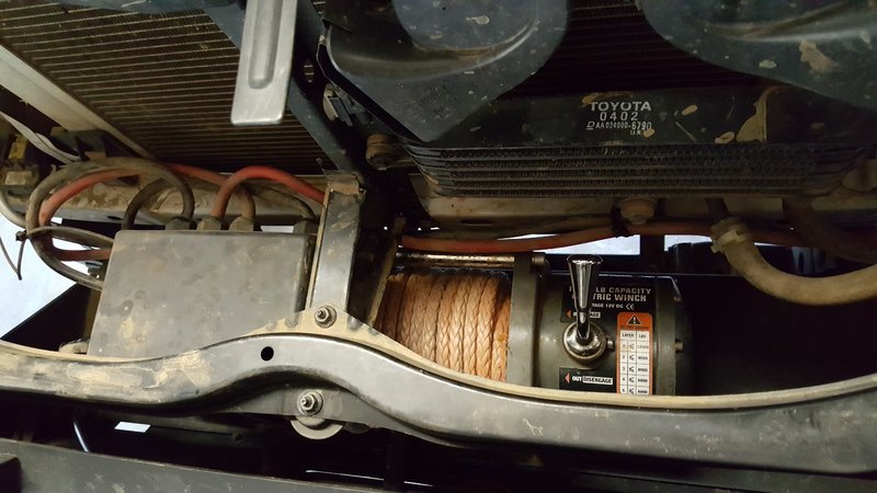

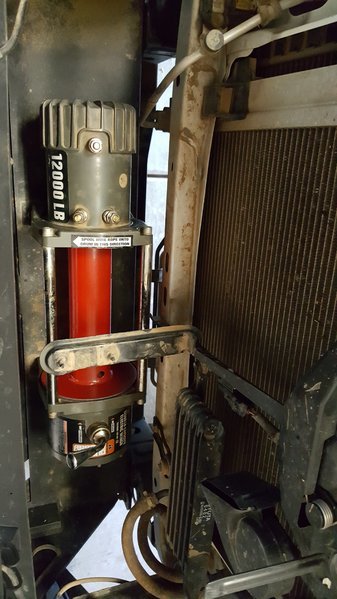

    Winch is back in...
    Turned out it didn't really need anything aside from the drum being cleaned up a bit. It was working fine and nothing was contaminated with water or mud or anything but I figure fresh clean grease never hurt gears right?
    I'll find out shortly if I got it put back together correctly and it all works :D

    Works good. All buttoned up:thumbsup:
    In retrospect, I should have painted the drum when I switched to synthetic line. I'm sure the wire rope scratched the drum all up and then the synthetic trapped moisture causing it to rust.
    Hopefully, with fresh new paint on there and synthetic line, it won't happen again.
