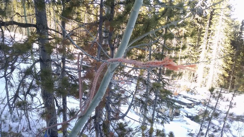

    Had some fun snow bashing...
    @aero3685 took some great pictures
    also managed to snap the winch line trying to pull myself through too big of a drift at too severe of an angle.
    I think @aero3685 has another line for me.... starting to think maybe I should wheel with him more often :D
    oh yeah, @BDN was there too. we managed to help him through the tough stuff

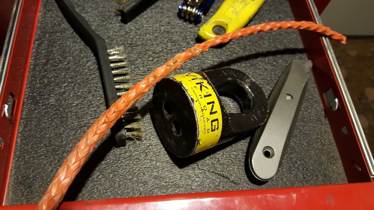

    After breaking my winch line, I thought maybe I should learn to splice/repair synthetic rope so that in an emergency I wouldn't be screwed without a winch.
    I got a new line from @aero3685 but it had what I considered to be an almost worthless metal loop on the end of it.
    The loop is too small to pass a 3/4" shackle bolt through so you're pretty much limited to attaching a hook, or factor55 bling. I guess you could pass a soft shackle through it too.
    Note that I was able to detach the loop this far without any tools or implements of destruction but because it's using a brummel lock, and the metal loop is preventing me from inverting the loop, I had to unspool the winch line to pass the long end through.
    I really liked the thimble on my broken winch line so I decided to attach it to the new one.
    4bA8yLgtpeh0-rFMudLX3ZOfenGkR4JinNa_Q_xx_f60a536c0fd22ceac1ce3329cbbe713c3dd89f53.jpg
    This one was attached with just a deep bury and some stitching that I had to cut.

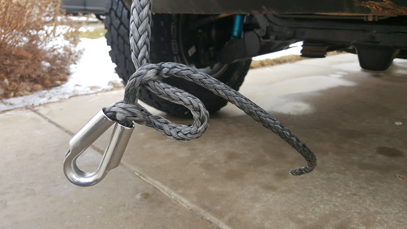

    After much wailing and gnashing of teeth (and some youtube watching), I finally came up with a good system for splicing synthetic rope.
    DONT WANT
    Duct tape. It doesn't slide nice through the center of the rope
    Any kind of pointed fid. It's too easy to "weave" a pointed fid through strands rather than staying nicely in the center of the rope.
    A knife. It's a bitch to cut the rope and even the strands for a taper with a knife.
    DO WANT
    Electrical tape. Low bulk, nice and slippery
    1/4" extension. Dull tip, nice and slippery.
    Sharp scissors. Cuts the stuff much easier.
    My splice kit
    Now I just need to put this whole kit in a cordura pouch, then in a Pelican case with foam cutouts, and then bolt it to my swing out for maximum EAF cred.
    I'm making winch line extensions out of the old rope that broke. I'm leaving loops of just the rope and just using a deep bury. They should hold fine and be easy to undo/modify if necessary in the field.
    I did use a brummel lock when attaching the old thimble to the new line.
