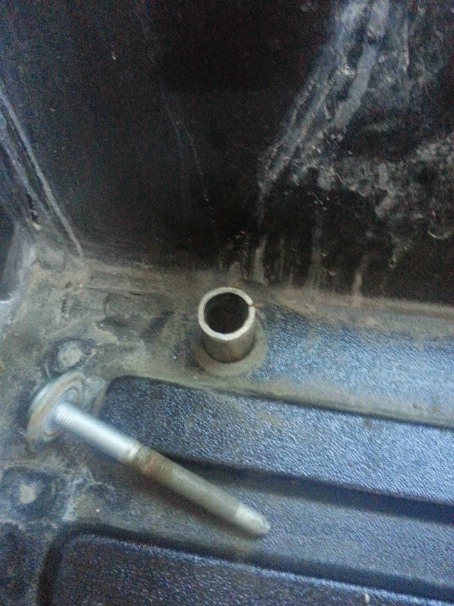

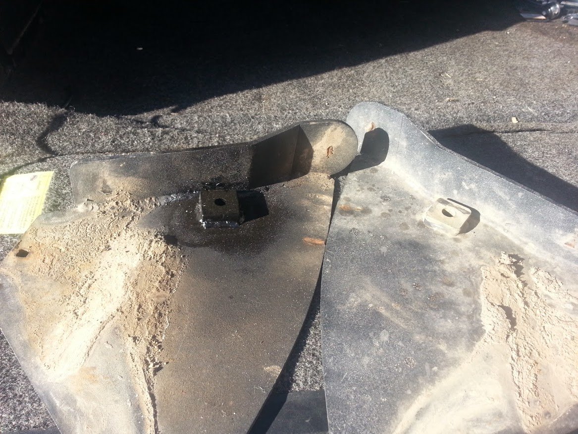

    No big exciting purchases or anything but I've been doing some maintenance getting ready for wheeling season.
    Finally figured out what was wrong with my LCA skids and why the driver's side was hitting the frame at droop.
    The driver's side was missing the shim that the passenger side had over one of the bolt holes. Thanks to Ray, that's fixed now.
    Also discovered I had a loose bed bolt. Passenger side front.
    Actually, the bolt wasn't loose at all. Rather this sleeve inside the bolt hole stuck up slightly higher than the bed and the bolt and washer were tightened down on it leaving about an 1/8" of slop. Since I was already at Ray's, we ground the sleeve down a bit and now that's fixed too.

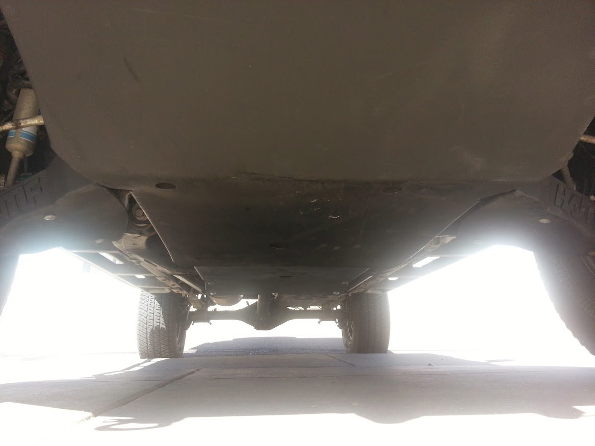

    Nice weather this weekend, so I finally got around to painting my trans and tcase skids. Pulled the IFS skid while I was at it and painted that up too.
    Pretty much set to go for wheeling season I think!
