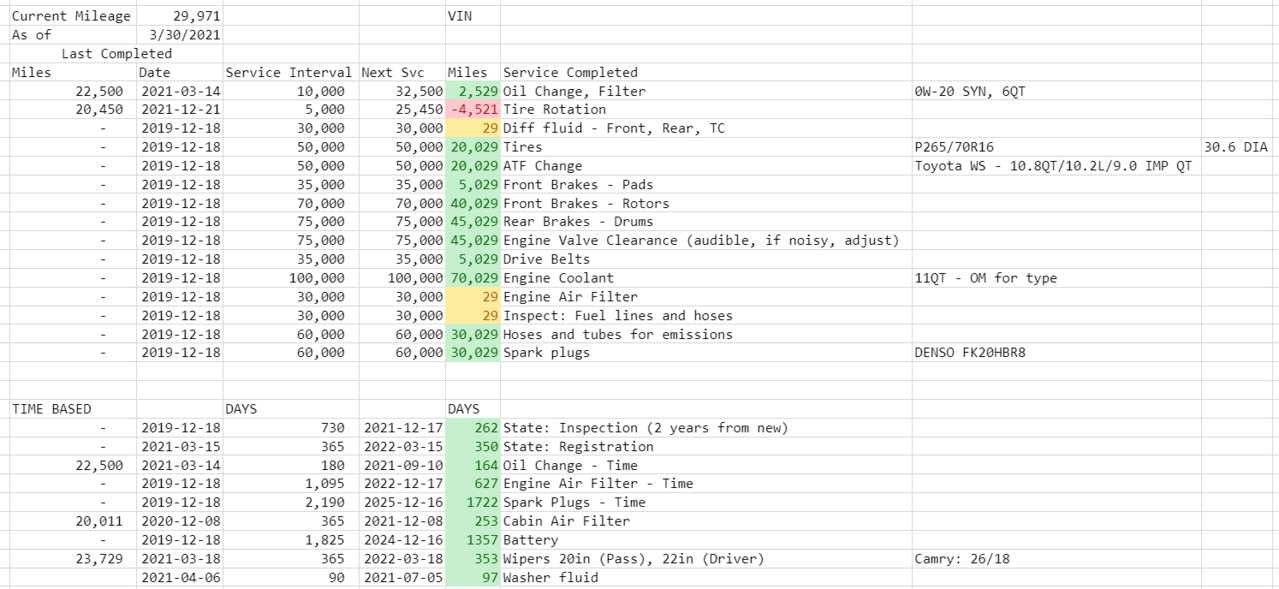

    It's essentially fuelly but home grown since I tie it into service too. Because I'm crazy. I track my fill ups so it tells me my MPG from that, and then I pull the most recent (date and miles) and that gets pushed to my maintenance log and I can track what needs to be done when either on time or mileage based. As things come up, I add them to the list of what I need to do.

    Ok are you a bookkeeper? o_O

    I have a degree in Mech Engineering and work in Aerospace QA - not a bookkeeper, but just as crazy :rofl:

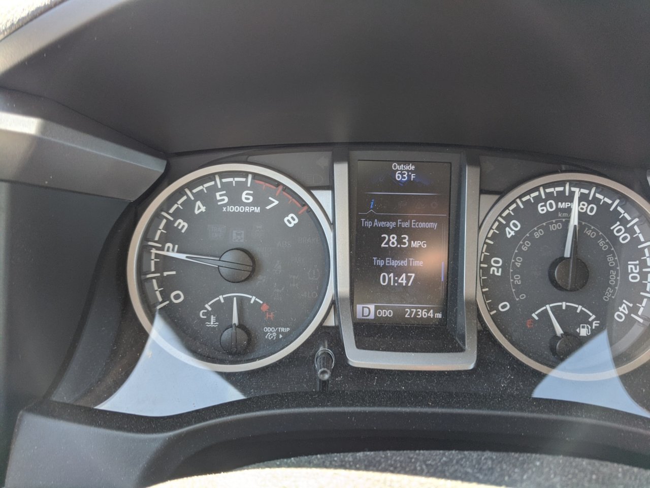

    Hour:47 on interstate at 70mph after about half the tank of in town driving.
    I think they should be able to advertise specs like internet speeds. "UP to" 28mpg
