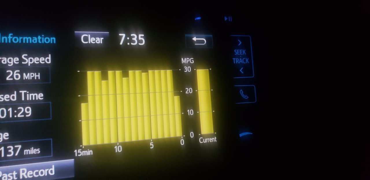

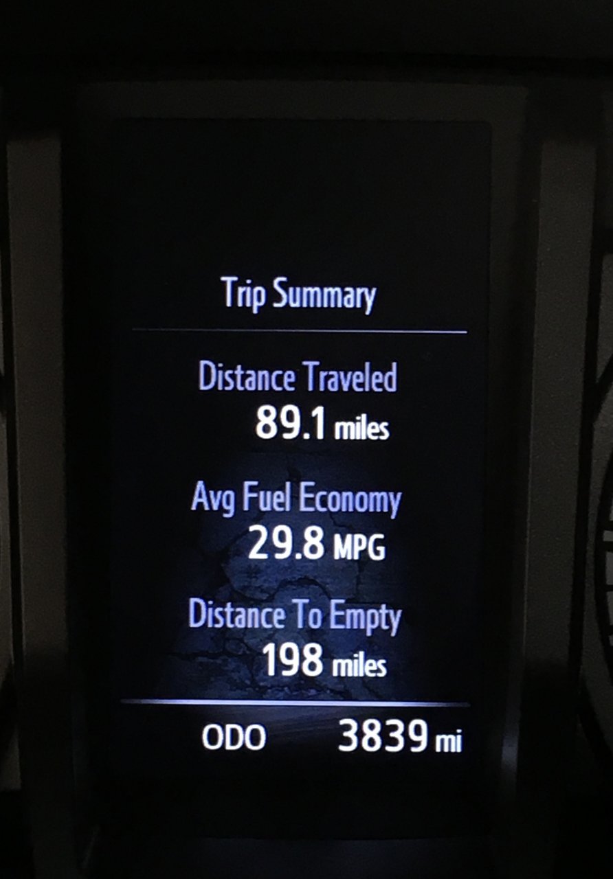

    In the interest of this thread I've posted a related pic... 29.8 mpg over 89.1 miles... Volcano National Park to Kailua Kona, single lane roads only.
    The whole vacation I did 246 miles and averaged 24.1mpg

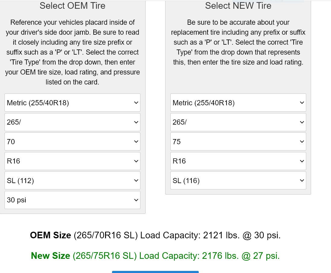

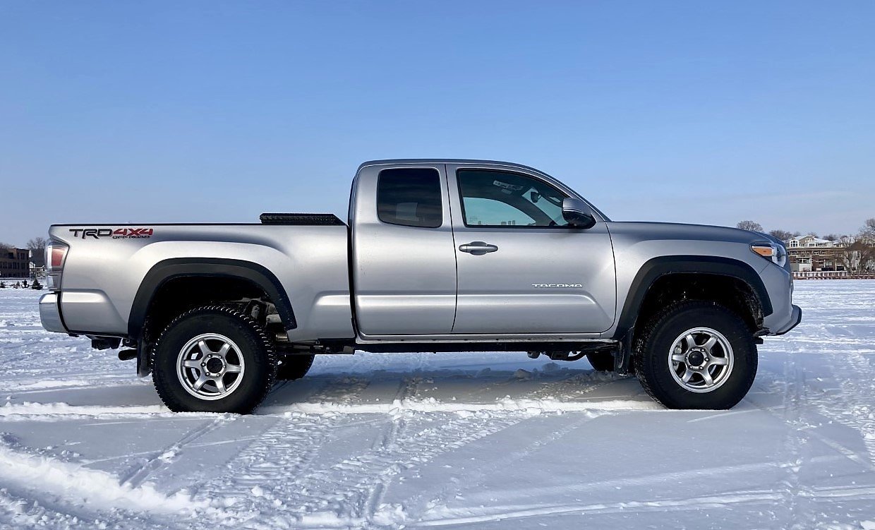

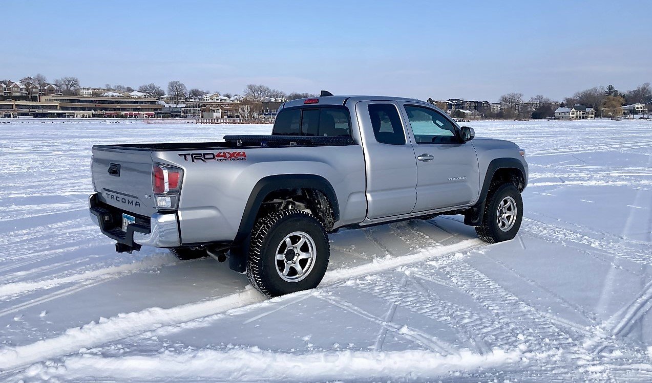

    I have the same tire in 265/75-16 size... same overall diameter as what you plan on purchasing.
    Using a load rating conversion calculator for psi, I went from the standard 30 psi cold for stock tires to 27 psi (higher load rating on the larger size Michelin, therefore less psi required). Per the PSI indicator on the dash, after the tires warm up, they go from 27 psi to 30 psi or more. The Defenders are very quiet, light weight and have minimal rolling resistance. Your speedometer will read correctly also with the new tires.
    photo of what they look like with slight lift.

    Whoa I expected to raise PSI but down instead? Do the tires never look sort of smushed ? My Toyo stock tires look kinda smashed at bottom from the weight. It’s why I wondered if I should increase PSI

    Radial tires will always look a little "smushed" at the bottom. But higher PSI (above what is on the door of your truck or what is recommended for the tires) tends to provide better MPGs and crappier ride quality (harsher) and, at an extreme, uneven wear of the tread. I would recommend something in the mid to high 30s for a conventional road tire, but obviously you air down for a more supple ride or better traction.

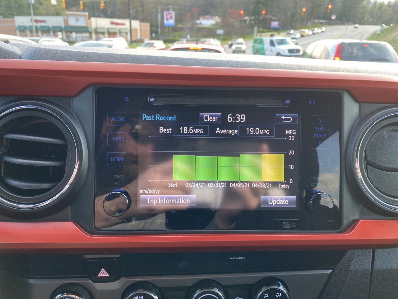

    This is the mileage I’m getting 8300 miles in ...
